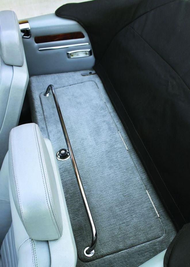

Philhef ... what did you use for the metal bars?
Ken
Old May 7, 2015 | 05:46 AM
philhef's Avatar
Posts: 2,916
Likes: 547
From: North Carolina
Ken
I used thin aluminum strips from Lowe's home improvement, cut, rounded and drilled the ends, screwed down with screws and domed washers, then finished with very thin chrome self stick auto trim between the washers from Autozone. (Also made custom umbrella holders!)
Old Sep 28, 2020 | 04:27 PM
SamtheSham's Avatar
Joined: Dec 2016
Posts: 1,323
Likes: 483
From: S.W.Florida
Default Rail, Where??
Originally Posted by philhef
Attachment 55499
I like this.
Phil,
I saw this pix on an earlier thread. Where did you get the rail? Was it custom??
