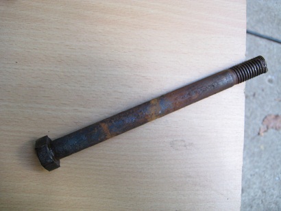

Success!
Finally managed to shift this bolt. I suspect it was eventually a combination of heat n' hammer!
Thanks for all the suggestions.
smithtrevor:- the Plusgas is on order and the powertool looks really useful - I'll probably get one for next time!
Here's a picture of the sucker, doesn't look like the last person copper-greased it.
