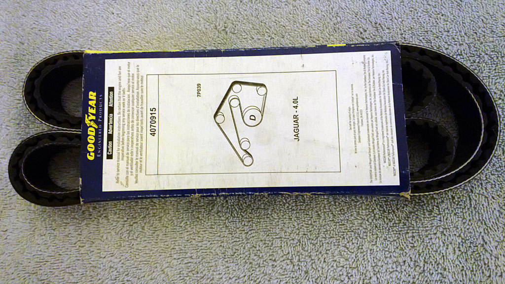

What a coincidence, ExportGuy!
I have the exact same belt (took a pic below ). I actually had Coventry Cars mechanics trying to get it on, and even they failed!!! It surely isn't your fault if Coventry cars mechanics in San Diego can't do it either!!! They offered OEM Jaguar belt for >$100 which I clearly refuted .
I have Gates K070916 currently sitting on my table. Hope the "16" in the P/N will make a difference. I will report back tomorrow during the day (PST ) on the progress.
BOTTOM LINE, GOOD YEAR GATORBACK AS PICTURED BELOW DOES NOT FIT 1999 4.0 ENGINE!!! Quite puzzling...

I am back with good news, ExportGuy! The Gates fits perfectly! I also happened to be replacing it on my own for the first time btw . I borrowed a kit from local Autozone, but all you really need is a good, longer breaker bar with 15mm socket...preferably deep socket.
Once I compared the GY Gatorback and Gates it was quite obvious that fitting the former would be impossible due to the deficiency in length. One could humor me why Good Year uses the Jaguar 4.0L designation with the very exact belt-pulley routing on the retail sleeve ...

There are a couple of interesting points here. The numbers on belts are codes for what the measurements and properties of the belt are.
These 4.0 liter engines changed the length of belt they used in 2000.
The Gatorback 4070915 indicates that it is a 7 groove belt (number 7 in stock number) and that the length is 91.5" long. For my 2002 it specifies that a Gatorback 4070923 is needed. Thus it is 92.3" long 1.1 inches longer.
The Gates K070916 by this nomenclature would be 91.6" compared to the Gatorback 4070915 at 91.5 inches thus a 0.1" difference. It's curious as to why that Gatorback was too short.
I am getting ready to change my belt today with a Gatorback 4070923 (2000 cars and forward). Why the Gatorback? It came as a spare (and new) in the trunk of another XJ8 I bought.
