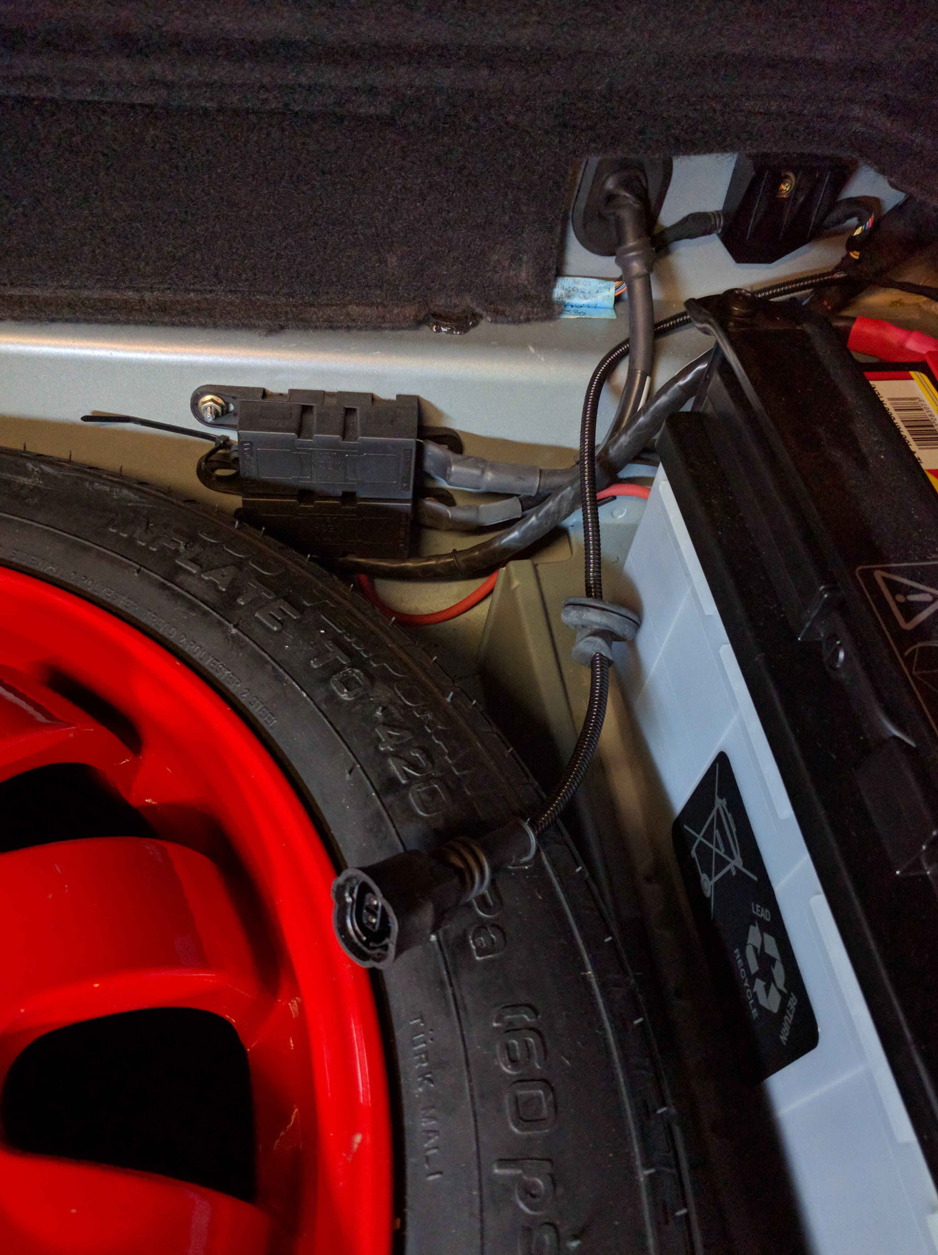

I just took a look behind the spare tire and found this cable....
What is that for?
In two weeks I have more time to analyze this fuse box. But that cable makes me curious.

Absolutely, I do not know what that cable goes to, but mine is plugged in, I think you might be on to something. That cable goes through the body, right in front of the battery, at the bottom of the trunk floor, and maybe, just maybe, plugs into the GPS antenna that is in the compartment that your top folds down into, that dead area behind the 'back seat', the antenna is near the middle, under the carpet, closest to the trunk.
Is there a way to take a pic to show me where this cable is supposed to be plugged in?

Wait a minute, your's is a coupe; mine a convertible, so, things look different in my trunk. It seems I have several smaller fuse blocks running along that area in my trunk, but that cable in your's has a 'body' grommet on it, made to fill and secure in a cut out hole. It definitely goes through the metal somewhere in your trunk. The SS wire wrap insulation leads me to believe it is somewhat exposed to weather, maybe it goes up to the third brake light, or the solenoid that pops the trunk open. I will have another look around my trunk, I have at least 3 cables that are unplugged at all times, but I think those go to DTC readers, however none have metal wire wrap. Oh and being that you have a coupe, your GPS antenna is on the 'parcel' shelf behind the 'back seats'; sorry about the confusion, I thought you had a convertible as well.

Originally Posted by mc_jag
Update about the Key Remote. I cleaned them but unfortunately without any effect. One of the keys is likely new anyway. As I already wrote I also changed the battery without any positive result. So, I guess it's either the transponder coil or the module. Can anyone tell me where it's located in the car? The coil costs about $20. So, lets try it...
Hi mc_jag,
The key transponder coil is around the ignition switch, and is how the car knows when you have the correct key in the ignition.
The antenna for the remote key fob is located at the top of the rear window in the coupe, and you should just be able to see the connector poking out the centre back of the headlining. Make sure it hasn't come adrift as that could be the cause of poor fob range.
