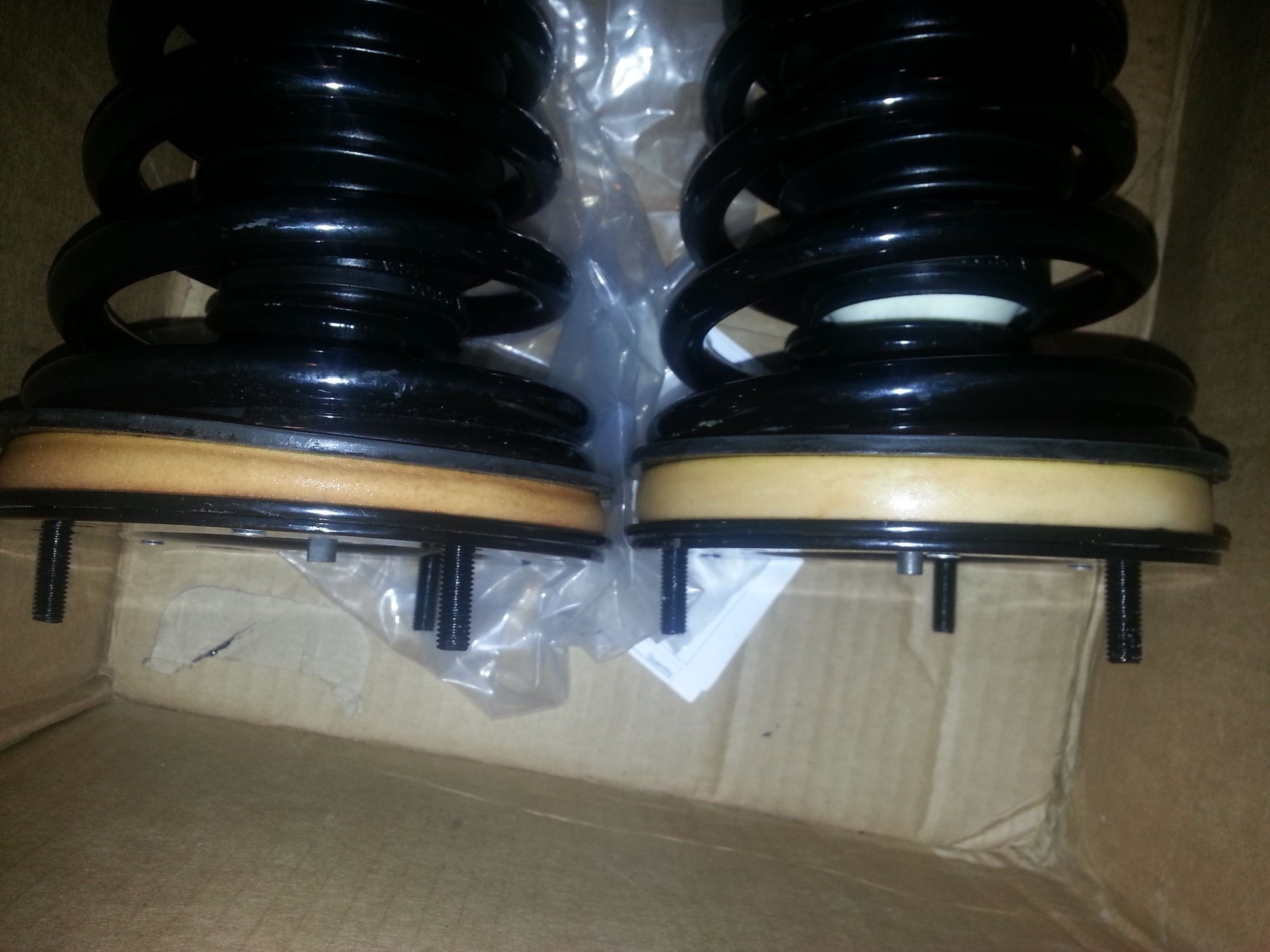

Tom,
Shows no compression side to side
See spring imprint by Finger; Pre-etched imprint opposite side (ends by yellow dot)
Hope this helps mate.

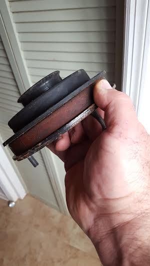

Originally Posted by tlynch
Tom
This is exactly how mine looked when I replaced the top mounts.

I've been digging in my folders for pictures of when I replaced my coils and shocks, but no luck so far. Will post if I find them.
For what it's worth, the current replacement of the bottom spacer no longer has the notch to seat the coil spring. I bought it directly from Jag, so pretty sure that's correct. However, I didn't feel good about it and used the original plastic one as it was in good shape.
The top of the coil on mine goes into a pretty hard plate, metal if memory serves, but definitely not soft. The top shock bushing is sandwiched between two metal plates as shown in your picture.
You can indeed add a spacer to raise ride height. I put 3/8" metal ones in mine to offset the (unintentionally) lowered springs. You should not need this if all components are new or up to spec. I do not recommend aftermarket coil springs for this reason. Spring rates can be suspect and this is a heavy car.

Originally Posted by Johnken
Tom,
Thanks for the pictures!
Tom

Originally Posted by RJ237
Your shock mount is correct, but the springs are either sagging or they have been replaced with lowering springs.
You can make plastic spacers up to 3/8" thick to place on top of the shock mounts.
My concern over the old springs are why I got new springs with my new shocks and mounts. I've been plenty slow with this. I don't want to redo parts of the process when I am done. I'll keep the spacer approach in mind if I still have the rubbing issue when these are in place.
Thanks!
Tom
Old Nov 10, 2015 | 05:57 PM
RJ237's Avatar
Joined: Dec 2010
Posts: 8,835
Likes: 2,924
From: Douglasville Ga.
Good plan. You can add the spacer without taking the suspension apart. Just jack the car up, disconnect the lower shock mount, and the spring assembly will drop far enough to get the spacer in.
Use the upper mount to make a pattern in case you need the spacer.
