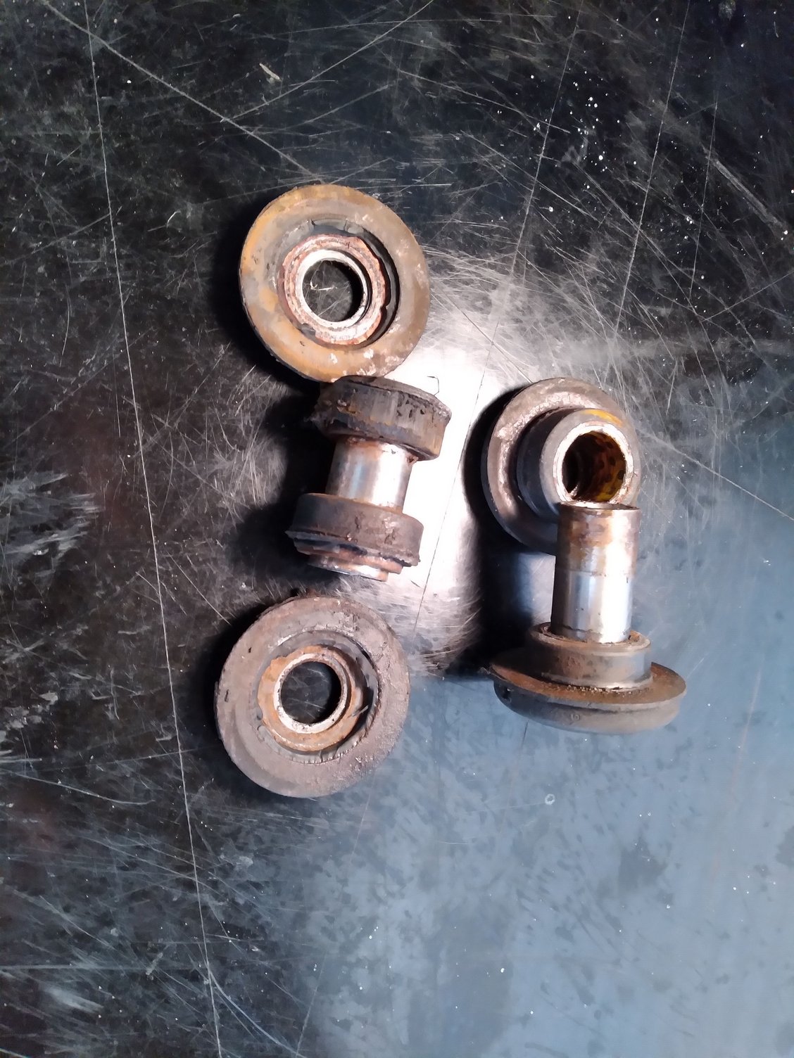

I was looking at the bushings on the upper control arm and I'm wondering if they're a two piece bushing because I don't see how else they would come off the control arm.
They look pretty good but as long as I have it apart if they're easy to replace I probably would.
I don't want to beat something apart that doesn't need to be beaten.
Can anyone tell me?
Yes, they're two-part with a sleeve:
Part # is MJA1462AB.
They can be a pain to replace if the inner sleeve gets stuck to the fulcrum bolt, otherwise it's pretty straightforward. There's no seal where the bolt passes through the crossmember, so water can wick along the bolt into the sleeve.
There are four shims of varying thickness on each axle, divided between each inner bush and the subframe. Note their positions on disassembly and make sure that they go back in the same place as they affect castor. See this post from blindside:
https://www.jaguarforums.com/forum/x...2/#post2277155
Put lots of antiseize on the the fulcrum bolt when you reassemble.

OK, so I can put the control arm in a vise and remove the bushings although they might put up a bit of a fight, right? I just want to be sure.

I felt confident enough to go for it and it wasn't bad at all. I put the upper control arm in the vise and got the bushings out.
I also tried to remove the ball joint in my 6 ton press but that wasn't showing progress so I'll farm out the ball joint replacement along with the shock and shock mount replacement once the parts arrive.
Here is what the bushings look like. One sleeve slid right out of the control arm once I got one bushing off. The other one put up a fight, I imagine due to part of the bushings remaining on the sleeve.

Glad you got lucky. That steel-bolt-through-aluminium idea should have incorporated some form of seal on the inside, exposed, section IMO. Perhaps an 'O' ring. I just squeezed some (lots of) waterproof grease around the bolt shank where it enter the subframe behind the shock.

Maybe the sleeve is because of what you mentioned. The bolt will come out, then you can deal with getting the sleeve out of the control arm on the work bench.
There was some corrosion on the control arm once I removed the sleeve. I cleaned that up and there is some light pitting but not too bad. The dremel tool that I hardly ever use came in real handy for that.
