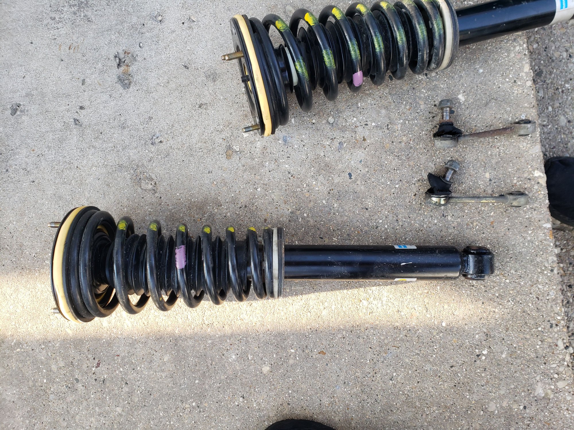

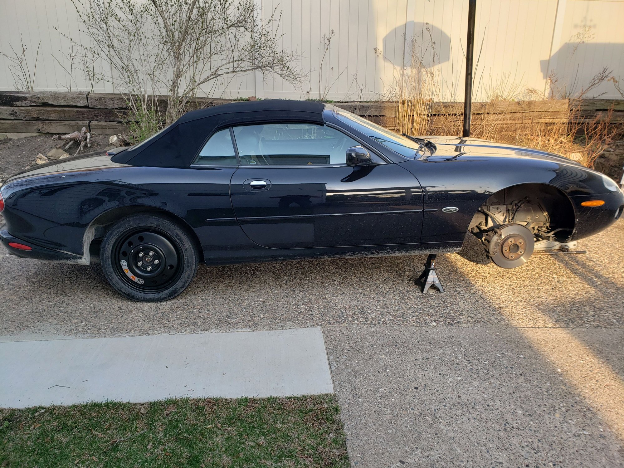

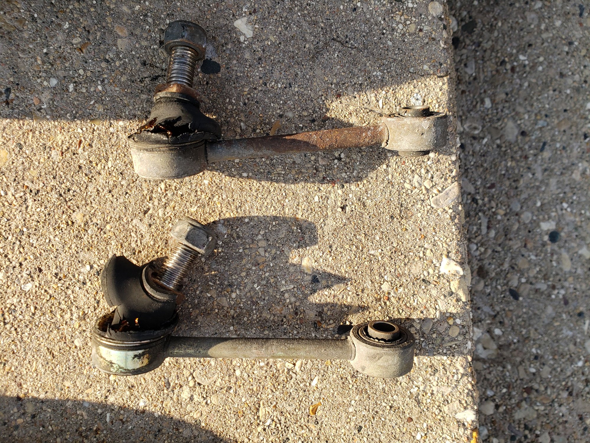

Old May 4, 2022 | 06:23 PM
  #28
JEZZA's Avatar
Joined: Apr 2022
Posts: 37
Likes: 17
Originally Posted by cjd777
I find it interesting on the total re design on the Welsh system.
Hope they read the big thread and gathered some good information. Baxtor and I sure gave it our best effort.
If they ask, I'll send them a set of our best.
Well I got my struts out today after work. It really it only took me maybe an hour and a half. I had fun just before then though I was driving down the road and I hit a chunk of metal or something on the road caught a hole in my brand new tire one of my brand new tires the rear one and of course it was a Dunlop signature HP and I cannot find them anywhere like ordered one from place we'll see if it actually shows up. Anyways as I was doing it my sway bar links are garbage and I asked the shop to look at everything and make sure everything is good if not we will replace it well apparently they didn't see that somehow It was so obvious Ray Charles could have saw it. So anyways it's going to order new links yay me money money money money money it seems..
Ouch. Financially painful in multiple ways! Good luck w the replace tire search.
