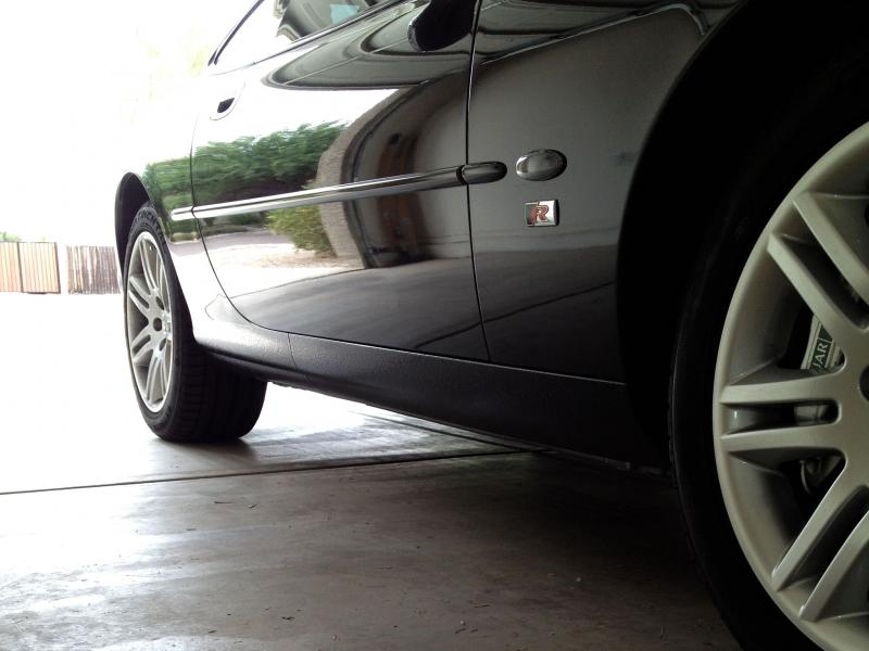

Today's project was to install rocker covers. I didn't care for that orange peely chip guard stuff and thought the car could do to look a little nearer the ground.
Before:

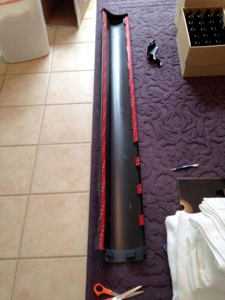

I like the simplicity of the OEM ones vs what is available in the after market but wasn't eager to drill holes in the rocker for the stock clips so I opted to use 3M double sided molding tape instead.
Cleaned everything with 99% isopropyl alcohol to get off any road grime and wax and also also cleaned the surface of the cover where the tape would be.
For the 3 tabs nearer the rear, the tape is double thick so that it is almost flush with the lip of the cover. This is the part that runs across the quarter, where the body is a single piece. From the door forward, the lip tucks into the rounded edge under the door and fender so having the adhesive surface inset a bit gives a nice tight fit.
At the front and rear, I put a line of tape along the fender flange on the car. This one was easier to put on the car rather than the cover.
I was a little concerned with using tape at first, but with a strip basically running the entire length at both the top and bottom it should hold pretty well. I can get a hold of the cover and shake the whole car without it budging at all.
