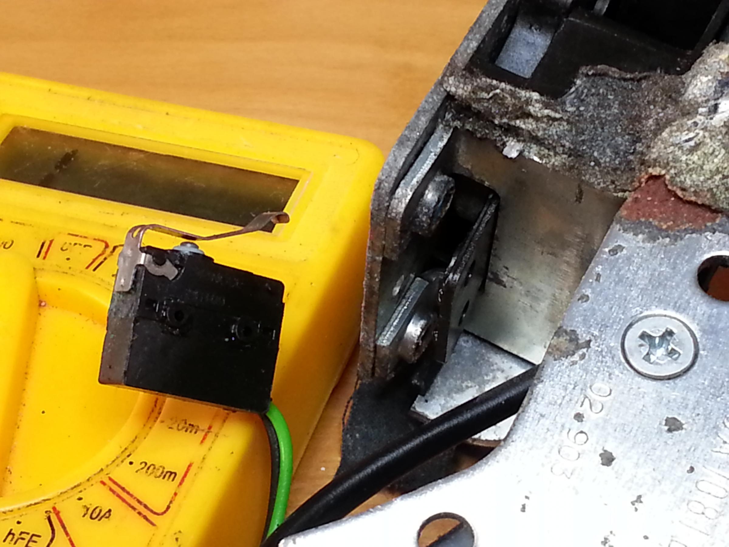

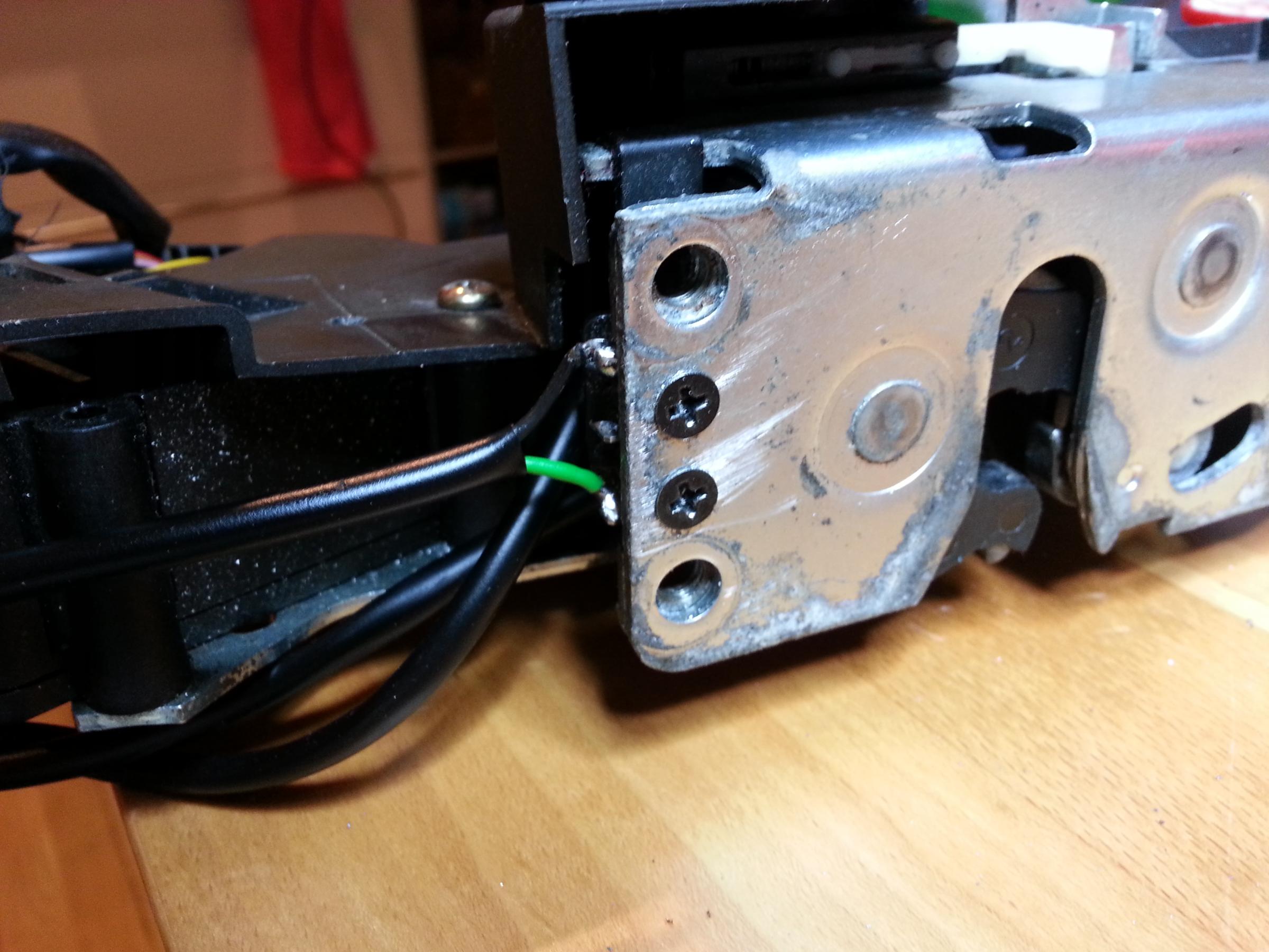

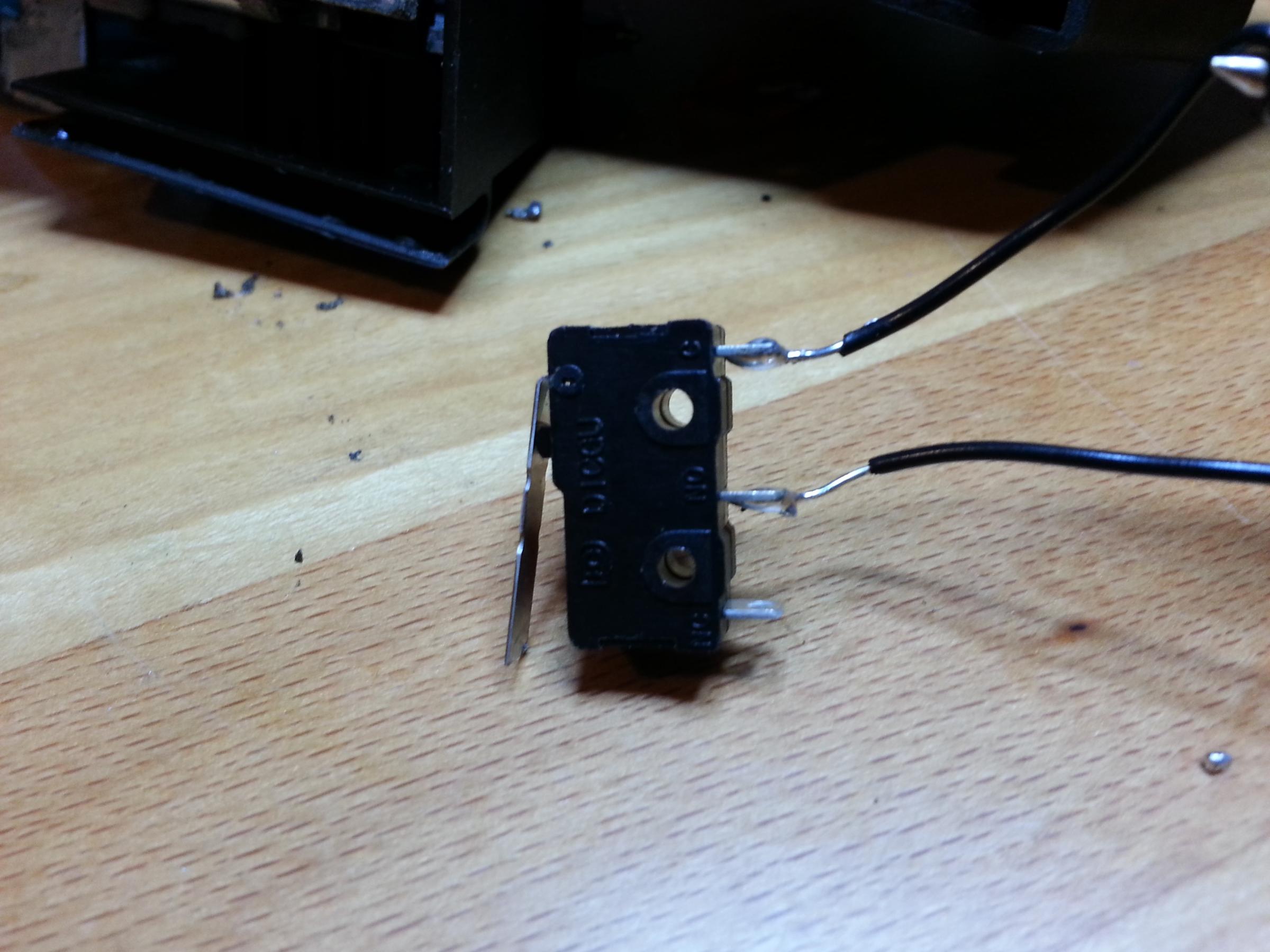

OK Chaps - success!!!
Firstly I would like to mention once again that without the Revs videos I would not have attempted this and in so doing I reference 3 of his masterclasses, The door card removal, the lock/latch assembly removal and the window adjustment videos so many thanks to him for sharing his experiences.
Apart from wanting the car back to normal I was motivated to carry out this work personally because the only alternatives on offer were the usual silly money costs.
The good news is that I was able to source an almost perfect replacement microswitch from Maplins for around £2.
I have included some pictures of the switch and assembly. The switch arm needs to be reformed slightly so that the eccentric that is part of the latch 'hook' activates it correctly but the mounting hole line up exactly with the holes left after removing the faulty switch. Incidentally Randef this is undoubtedly your problem as well as this switch also tells the system that the door is open so will ensure the internal light remains lit as well as watning you that the (affected) door is open and you won't be able to lock the car without the alarm going off.
The switch requires that the 2 mounting holes are drilled out slightly and as you can see, the screws that you will need to mount it will require the frame holes to be countersunk.
Do note (as per Rev Sams video) that it is VERY IMPORTANT to DISCONNECT THE BATTERY as the window mechanism is powerful.
After work has been carried out you will need to short earth lead to + and then set the windows as usual. You may find that you need to experiment slightly with the bend on the switch arm to get the eccentric to activate it correctly. In the locked position, although (removed from the door) the lock claw has a degree of movement, the microswitch must remain depressed until the claw is release (which would normally release the door)
I am guessing that being an American company, Maplins parts are available in the US.
Let me know if anything is unclear and I will try to elucidate further. Meanwhile here are some pictures. The switch connections are the 2 outside ones.
Regards to all,
Larry
