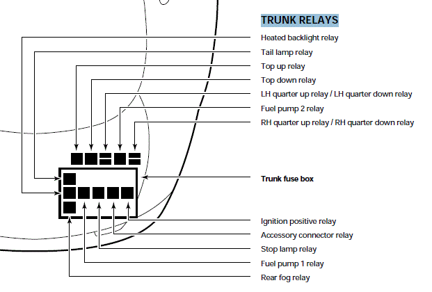

The fuel pump relay is triggered by the ECM, tail & number plate lamp relay by the BPM.
A couple of fuses to check for starters. The fuses are numbered, but you need good eyesight or a magnifying glass to see them
Trunk/boot fusebox:
F19 (5A) for the RH tail lamps and number plate lamps
F21 (5A) for the LH tail lamps
Aas Jay suggests, are you getting a 'bulb fail rear/check rear lights' in the dash message centre?
Note that MY2001 on there are two separate tail lamp bulbs on each side. One is a 5W single filament, the other is a 5/21W, where the 21W section isn't used.
Fuel pump relay is F3 (5A) also in trunk fusebox. Check also that the Ignition Positive relay (same location) hasn't gone AWOL. It's here:
You can download the full 2001 Electrical guide from member Gus' on-line encyclopedia here:
http://www.jagrepair.com/images/Auto.../jagxk2001.pdf
If everything above checks out, you'll need to do some basic tracing with a multimeter.
edit: You can swop any of the brown relays around to check them.

Thank you to everyone who helped me solve this problem. I was looking at the relay diagram on one of my replies and realised I needed more relays than I currently have!!! And by moving the relays I do have I can make different items come to life! (Shocker!)

You can get a set of handbooks from the stickies at the top of the main page, although you need 10 posts to 'unlock' access.
Note most cars don't have the optional accessory connector, so you needn't worry about having a relay occupy that position.
