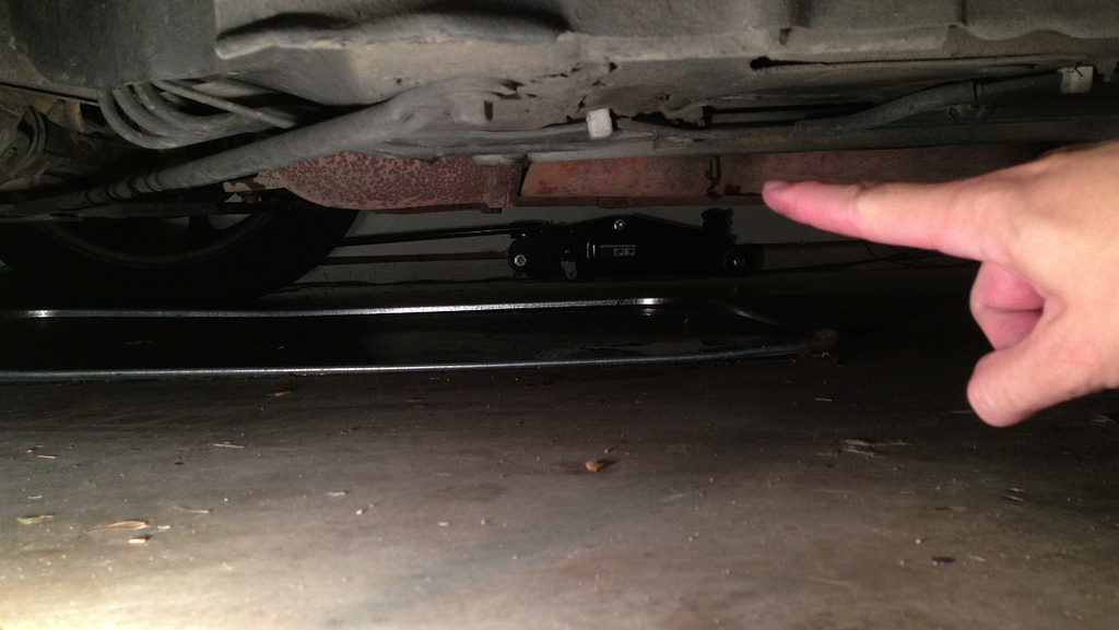

Well after no luck being able to successfully pressure test it even after pinching off all the lines around the reservoir and trying a dozen pumps on each (glad I'm getting my money back on that system- loaner), I think I found the source.
The drainage is dripping from the dead center of the car, closer to the front of the engine, and I'm seeing active seepage from the 1" hose coming off the bottom of what I believe is the thermostat housing. My radiator and other hoses look fine and no bulges, but there's a small coolant puddle underneath that thermostat assembly on top of the engine in a crevase.
See the screw-on hose clamp in the center of the picture? You can probably even see the tiny pinprick reflection of the seepage from the bottom of the clamp, not at the top of the hose, so I think (even though this was apparently already replaced) the rubber needs to be replaced. It's not even quite on all the way up, adding to the evidence. The bad part is... where does this go? I goes under the supercharger nose and out of sight... how difficult is this going to be to replace and what is it called? Is there a diagram someone can provide? I don't see this assembly under reference at JagRepair.com, at least for a XKR.
Also of note, I found the radiator fan assembly totally ajar! It was hanging loose an inch from the radiator right in front of the belts. I wonder if this 'inefficiency' caused this hose to start leaking as it may have been the weakest link and started to go first. I dropped the fans (working fine) back on top of the radiator where it apparently just hooks on top-center (no bolt holes I could see on the sides) and appeared firm. If you work in this area, WEAR GLOVES! The shroud is fiberglass (think about it) and I'm now nursing several micro wounds. EDIT: just checked a similar write-up on JagRepair.com, there are two bolts, one on each side at the top, that I will address now.
This is standing over the passenger side of the car with the supercharger on the left, front of the car on the right.
