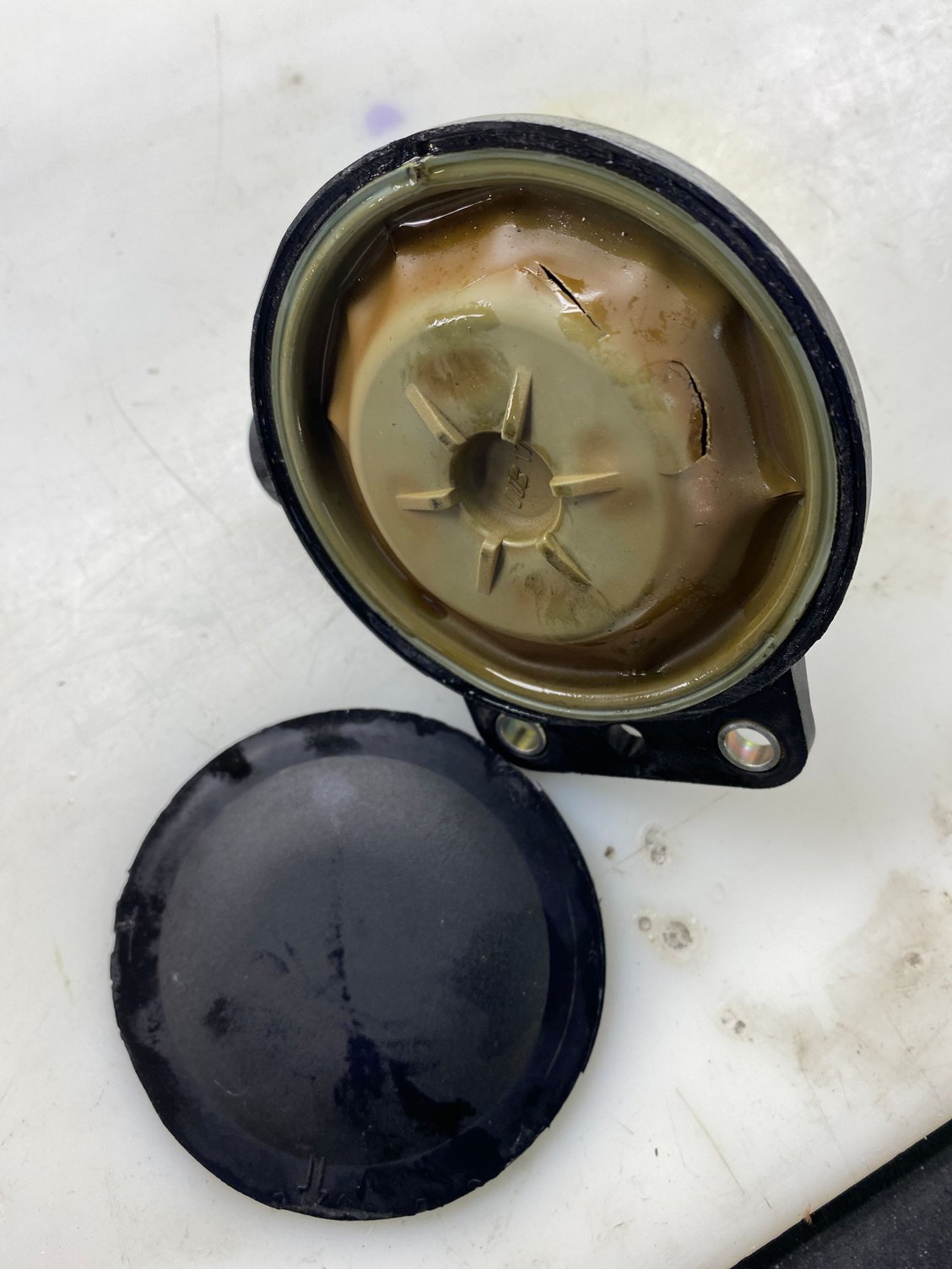

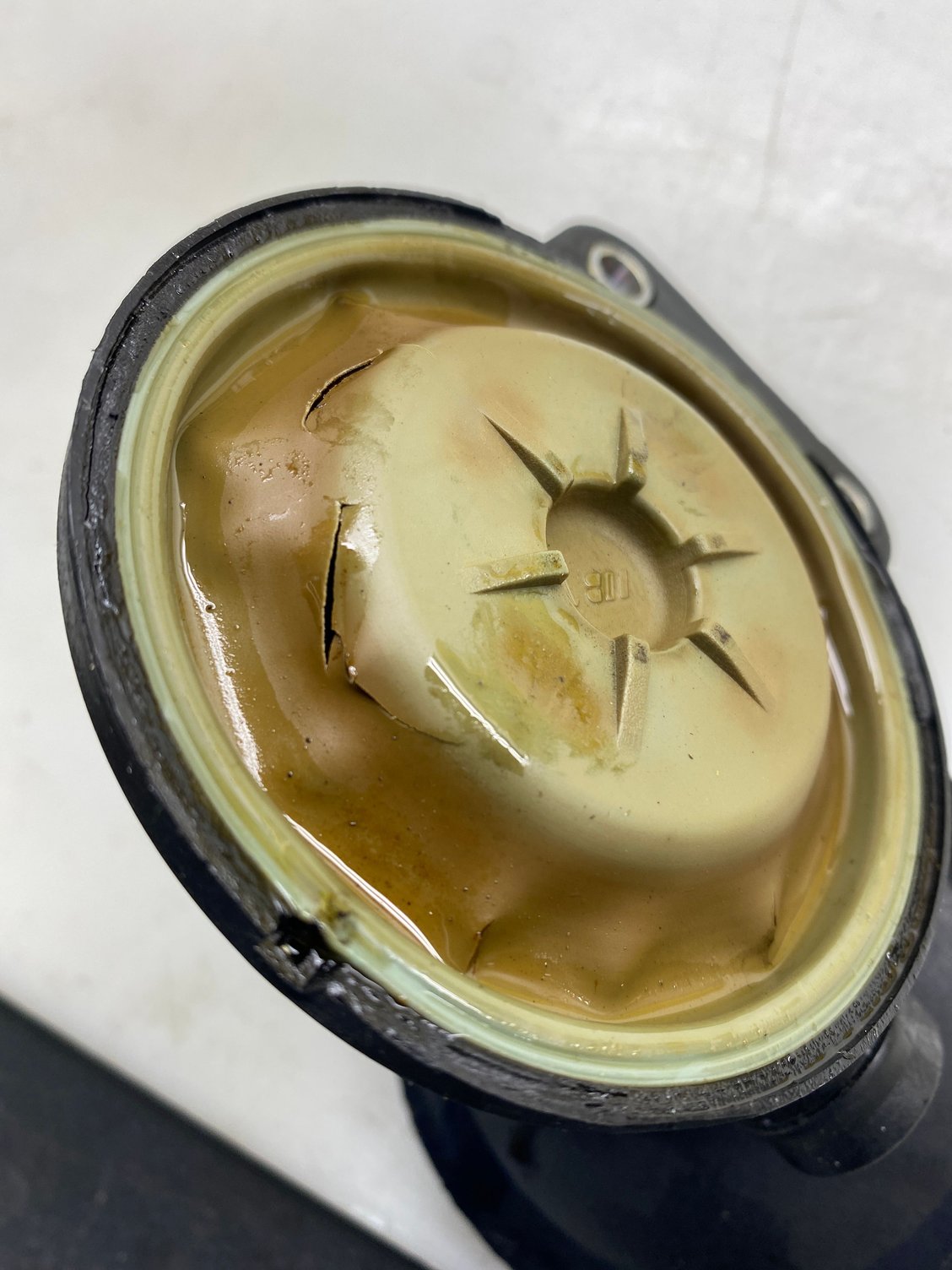

Decided to do some in-depth investigation so pulled all the plugs and got a scope to look at the cylinders. Sure enough the piston tops were “wet”, plugs were oil fouled (new plugs a couple hundred miles ago), the intake below the throttle body was soaked with oil. Did compression and leak down test with good results, amazingly low leak down BTW, like 8%, compression within 10% across the cylinders, all pretty good for 145k miles. Yes the crankcase vent valve was oily. So, decided to disconnect and plug the line from the CVV to intake and just let the CVV vent to atmosphere, kind of like the old days before PCV systems were invented.
Oh wow, what a difference. No smoke, idle problem resolved, and it runs like a raped ape. Unbelievable really but a no brainer now that I think about all the symptoms I had. I don’t know of any way to test these valves as air freely passes through in both directions if you remove it. Yet that have a spring and diaphragm in them. So needless to say I replaced it and it the car now runs fine with no smoking.
So, if you suspect this problem on yours, just disconnect and plug the hose from the valve to the intake and see what the car does. I hope this helps someone else out there…….
