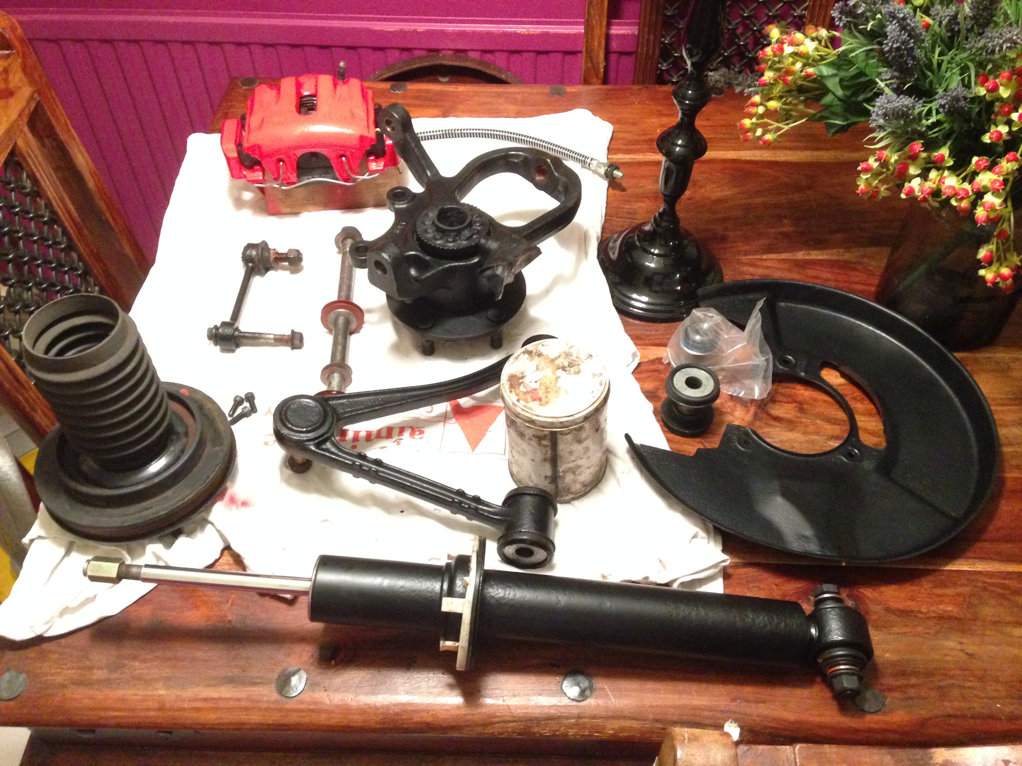

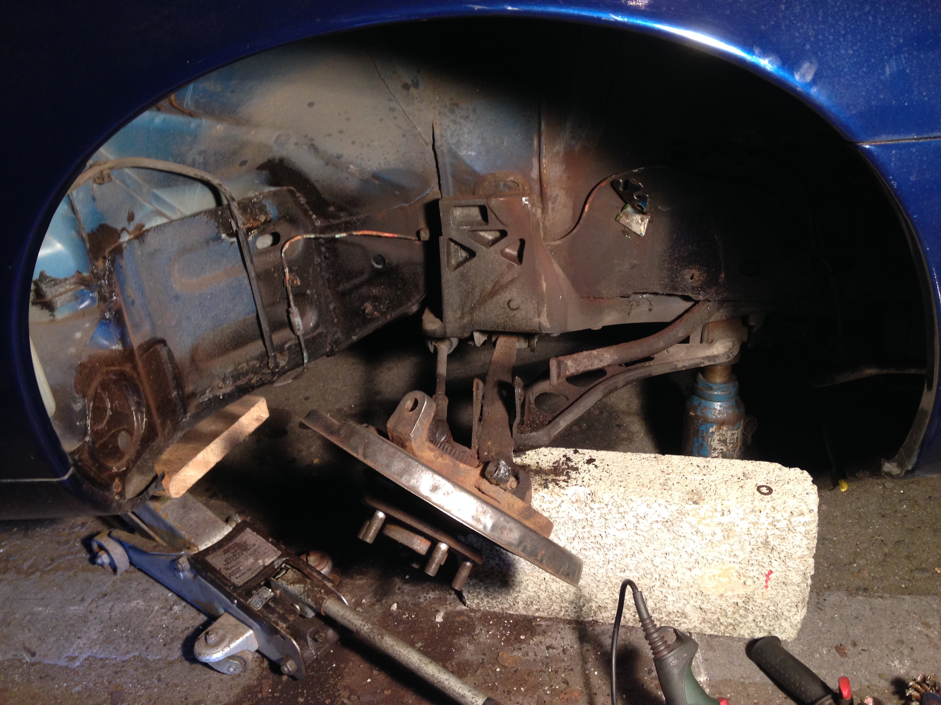

I am fairly new to this game and stupidly did no research before I made a purchase in Spring 2014.
After realising just what I had purchased, last year I completely de-rusted the underside of my 2000 XKR convertible, welded 2 new floor plates in the front foot wells or eventually this car would be scrap.

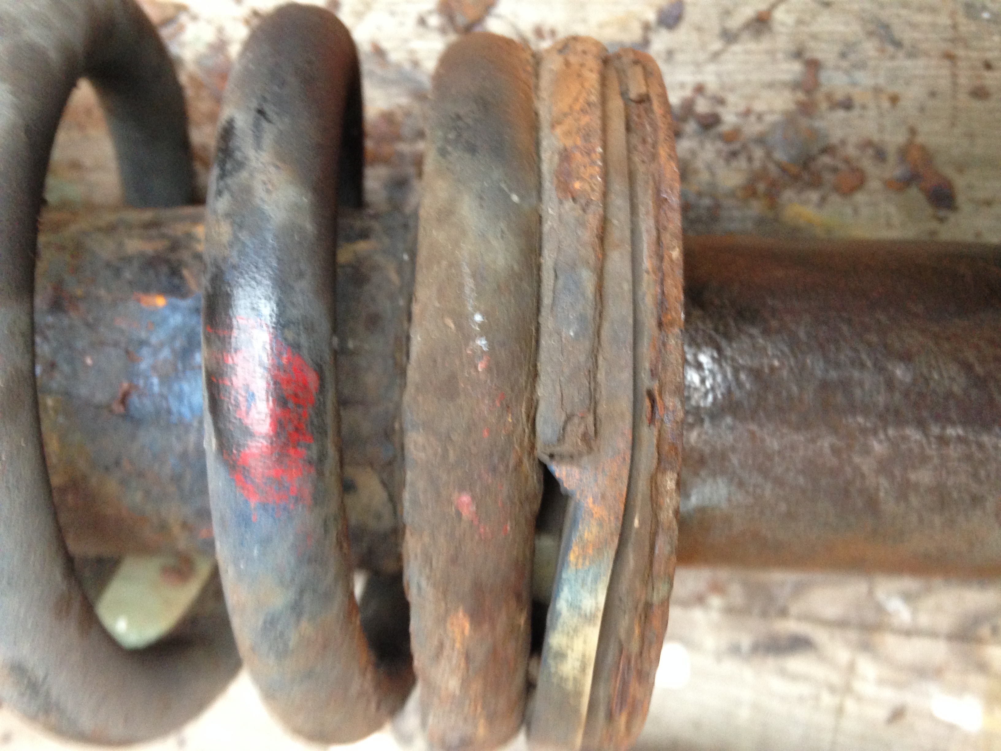

Over Xmas with a bit of time off, I thought I would finish painting my callipers red, so I started........, but on stripping out the calliper there was so must rust on the suspension parts, I ended up doing the following;-
1. Completely stripping out all, de-rust & paint.
To get the brake dust guard off, I had to heat up the 3 bolts with Oxyacetylene, came out easy after that. Ball joints split easy enough with my ball joint tool, but compressing that enormously springy spring with my spring compressors was probably the most time consuming & tedious bit.
Replaced
2. New upper wishbone bush.
3. New shock bush
Lucky my mate has a 15 Tonne press, came out easy enough. The old bush I used the outer case and machined a tool out of it for inserting the new bush, as its easy to damage the rubber otherwise.
So after all that, I thought may as well lower it now as opposed to do it as a later project, so uprated lower springs in bound from Powerhouse, Lawson the boss there is great for tips and advice, his lower crankshaft pullers are a superb mod to the steel bodied XKR's, he is also very reasonable with his prices
Now I realise I have to do this x 3, which I estimate is another 9-12 days work!!!!!
See attached pictures, That's my kitchen table by the way, I think my wife might kill me eventually with all this, lol.
So I have a couple of Camber questions for my lower springs;-
1. Will I need eccentric bolts for camber adjustment on my front wish bones, or are they already on the 2000 model?
2. And shims for the half shafts at the back, does anyone know a rough size worth buying?
3. Or once lowered have other owners not bothered sorting the camber out?
Cheers Pete

Hi . I have a 2000 XKR and am in the middle of powerflexing my front suspension, so I can relate!
I don't have eccentric bolts for camber adjustment, hope that helps. You can tell by looking at the bolt head which will have a single mark on it that indicates zero when vertical.
Have a good look behind the subframe if you can (or haven't already) as there is potential for rust in behind that. I'll be dinitroling the whole arches before it all goes back in.
My car was already factory lowered a bit, but when I did my MX5 I didn't bother changing the camber, and tyre wear and handling are both fine. But these are heavy cars and you may see heavier effects - tyre wear being an expensive one!
Cheers Kreyszig,
I think I will finish all 4 corners, take it across the road to my local computer tracking place and see how far out the camber is first before I plough another £100 quid into eccentric bolts and shims. Funny my wife has an MX5, interesting choice of we have old been, I wish my XKR was as reliable though, lol.
