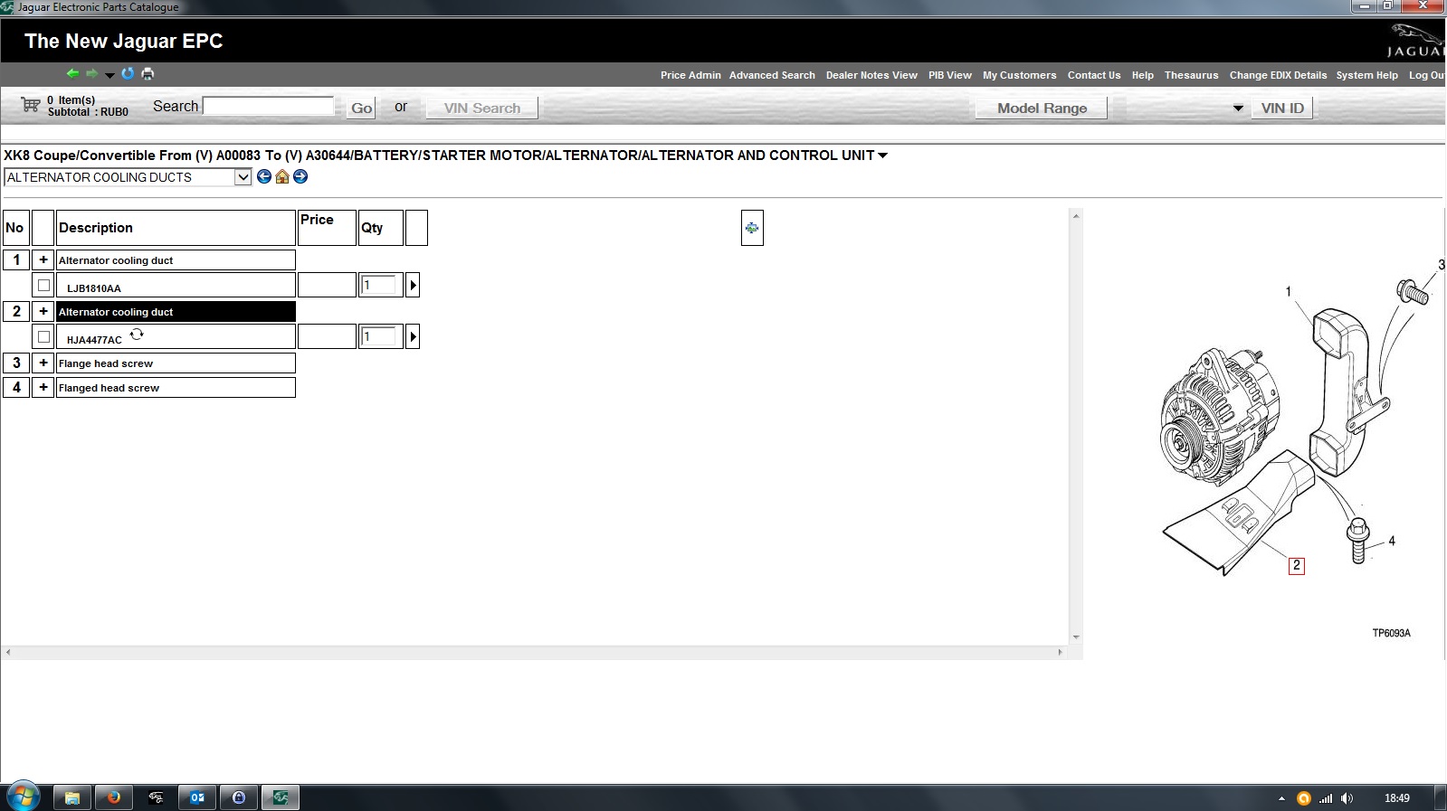

P/N HJA4477AC (Alternator Cooling Duct) has been superseded by HJA4477AD.
Forum sponsor S N G Barratt are showing this as no Longer available but Gaudin Jaguar are listing it at $25.31

P/N HJA4477AC (Alternator Cooling Duct) now superseded by HJA4477AD is item 2:

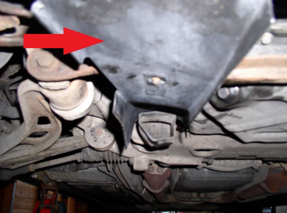

I would agree that its benefits for improving cooling are questionable but I can't ever see a situation where it could clog up (arrowed in red).
The tubular section (item 1) could possibly clog but I would certainly say it does do something to direct airflow to the rear of the alternator.
