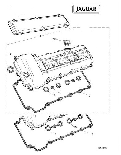

This is a regular issue. It's unlikely to be anything more serious than leaking rubber Spark Plug Boss Seals. See item 3:
Early cars have separate seals; later ones have them combined in pairs with the centre seal as a single moulding (see item 16)
To replace the Spark Plug Boss Seals, you will have to remove the Camshaft Covers so you will need a full seal kit. USA members will be able to advise where to find Ford alternatives to buying OE Jaguar.

Later cars have the separate seals.

Correct.
Early 4.0 Litre models were fitted with NCA2578BB paired seals. Later 4.0 Litre models were fitted with NCE2578BB individual seals.
4.2 Litre models were fitted with individual seals commencing with AJ82876 to VIN A33834 but this P/N was superseded 5 times throughout the production run.
I haven't seen as many examples of 4.2 Litre models as these appear less prone to seal failure but I'd expect the design has remained as individual throughout.
