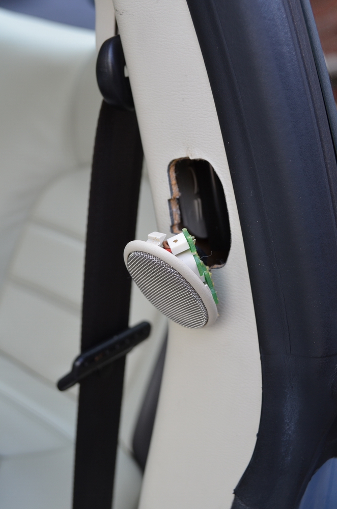

My 2001 XK8 has what looks like a small speaker grill on the front side of the post near where the seat belt is located. It is on the passenger side only. I don't hear any sound coming from it when the radio is playing. Is this a speaker or something else?
Old Jan 11, 2015 | 05:40 AM
Likes: 17,008

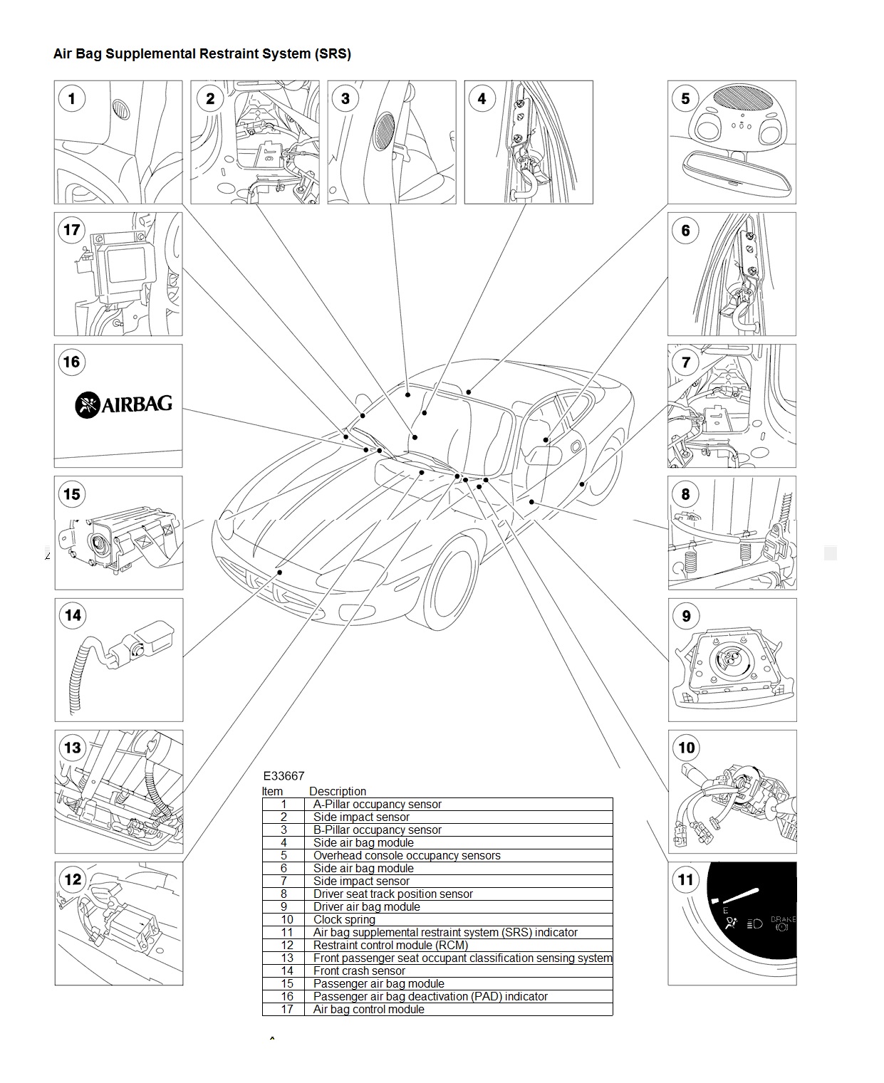

Occupancy Sensor for the Airbag SRS (Supplementary Restraint System).
Just hope you never need to know anything more about the SRS - faults can be a nightmare to troubleshoot!
