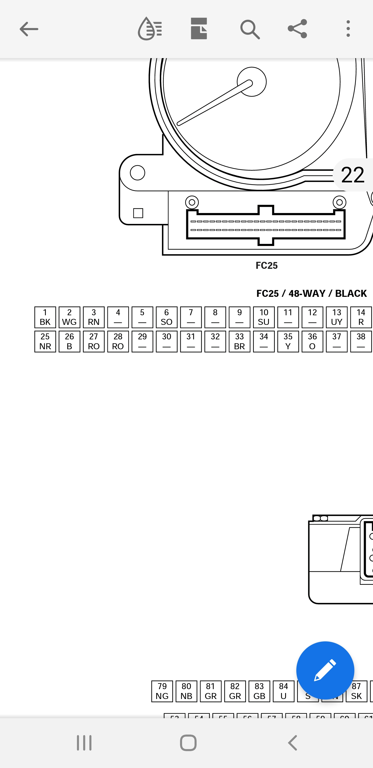

Missing photo
Attached Thumbnails Speedometer/instrument cluster-screenshot_20211128-210420_adobe-acrobat.jpg

I took the dash apart and tested voltage on the instrument cluster right at the bulb and got 12 V. I got 2 lamps to work, I think it is the lamp holders, they dont seem to be making tight contact to the instrument cluster. at least that is my theory. I should have tried scratching the bulb socket, to improve contact. , I suppose it could be that. I have a feeling that I will not be able to purchase just the socket that holds the lamp. Any other suggestions?
