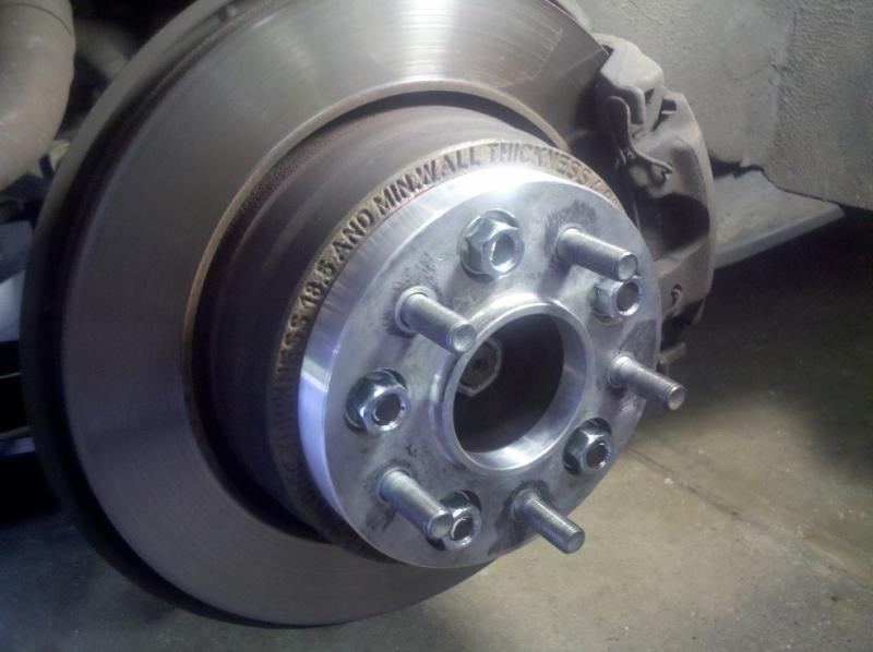

Thanks, Coupe, looking forward to getting them in. Those spacers, does the hub get replaced, or do they bolt on the present hub?
No, nothing gets replaced and installation is as easy as bolting on a wheel. I attached a snap, see below. You simply bolt the spacer onto the hub as you would a wheel, same torque specs. For my particular wheels (Double-Fives), the nuts holding the spacer on fit neatly into pockets on the rear side of the wheel, so no machining needed.
XKRacer generally says that there is no degradation in handling UNLESS you're running 20-inch (or larger) wheels. But for my 18s, I can tell you there is no discernible change in handling, and I've had some training. I will say that wheel spacers are items that must be of the highest quality. I trust Tony (XKRacer) and his experience counts for a lot. So I went with his product.
Once you get that extra width in the back, you'll never want to do without it. Just like you'll never want that inch of rear spring height back.

Hmmm, I wonder if they'll fit in my Hydras without machining. I'd hate to have to drill out metal around the bolt holes. I also run OEM Lamina 17in wheels on occasion.
I can see how if they developed a problem whilst driving it could be concerning. Did you set the parking brake when torquing the spacer bolts to keep the hub from spinning?
Tony (XKRacer) could answer the Hydra question for you. I wouldn't have wanted to machine them, either. Potential balance problems, etc.
My parking brake was a fourteen year old daughter, pressing the brake pedal while I tightened the bolts. Works every time.
