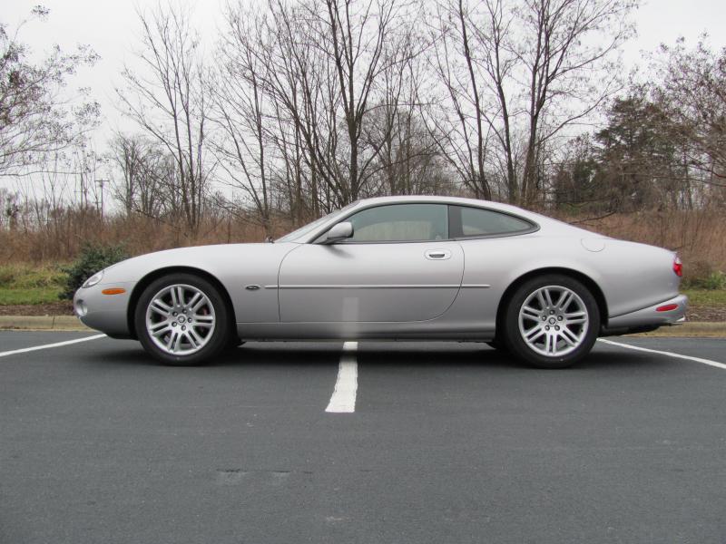

Here you go XO. Would have been sooner but the weather has not been cooperative:

Thanks a lot ! Makes quite a difference... Since installed, have you noticed any behavior or balance change with only the rear spring rates being modified ?
f-xo;
I can't speak for Skid, but if anything the handling of my car is a bit more crisp since I lowered the rear by 1.25". It was good before the change, and a bit better after. Certainly no deterioration in handling or unpredictability.
