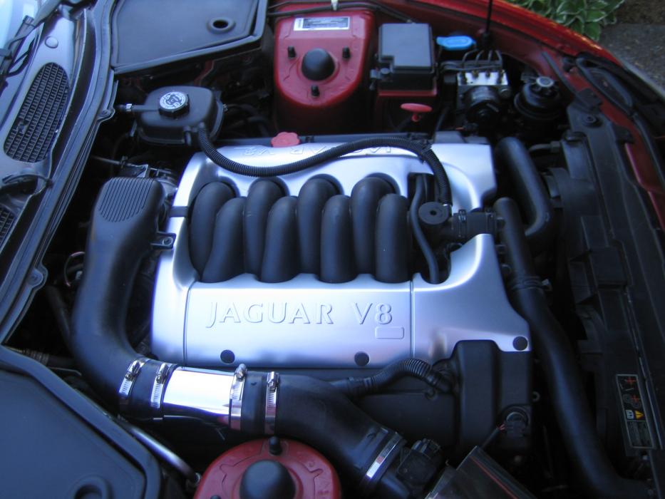

I had a mina on my 99 coupe, 6 years, and the only problems I had was with the snorkel pipe having cracks in the bellows area. Heat fron the manifold will deteriorate the thin wall and cracks develope. I fixed mine by buying an air pipe from pep boys. You know the six inch chrome type the rice burners use for air. It came with silicone hose pieces. all you need to do is buy some big breeze clamps and put it in after you cut out the bad bellows. Under $25.00.
Or buy a new snorkel from jag $65.00.

Photo of the chrome pipe.
