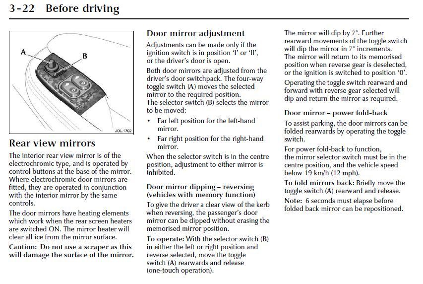

Wait, these cars have folding mirrors? How do you activate that?
Old Sep 18, 2018 | 07:22 AM
giandanielxk8's Avatar
Posts: 3,787
Likes: 1,675
From: Puerto Rico
Oh, that seems simple enough. I'm going to try it later. Do all X100s have that function?
Not on my '97. Must have been an option.
Old Sep 23, 2018 | 01:43 PM
Posts: 3,787
Likes: 1,675
From: Puerto Rico
I think my '04 also doesn't have it. I tried those steps and nothing happened. I do have the reverse tilt function. So that is something. I also doubt I have heated mirrors.
