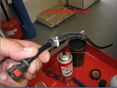

I have decided I'm going to apply the fix from here:
JagRepair.com - Jaguar Repair Information Resource
As seen in this picture:
He removed the throttle body elbow hose, cut up some of it, and used a rubber hose and a couple screw clamps to solve that problem. It worked for him. I think it will work for me. Mine is not broken flush with the thottle body so I could get away with this and it would cost me very little. If that doesn't work, then I'll check with Jagbits.

This definitely worked for me. It cured my stiff brakes and slight almost imperceptible roughness to my idle. I'm pleased with the results, and I only spent about $5.
