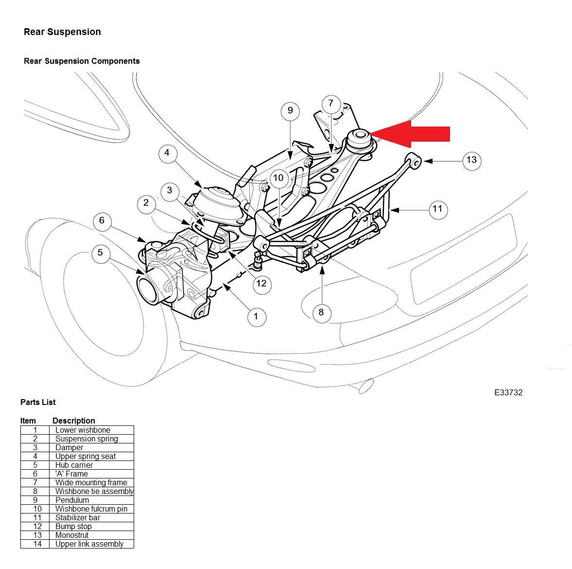

After eliminating brakes and wheel bearings as a possible cause, it's worth checking the 'A' Frame bushes (RH arrowed in red) for wear before moving on to diff or driveshaft.
Strange noise/vibration - RESOLVED-xk8-rear-suspension.jpg
Worn or split bushes allow metal to metal contact with consequent transmitted vibration.

Thanks Graham,
I have a feeling it is a wheel bearing, I had the car up on axle stands yesterday evening and there is quite a lot of play in the wheel and it does have a rough sound when rotating it - strange because whilst driving that is not evident other than as I described it before. I had sort of discounted it originally as they have been replaced relatively recently.
