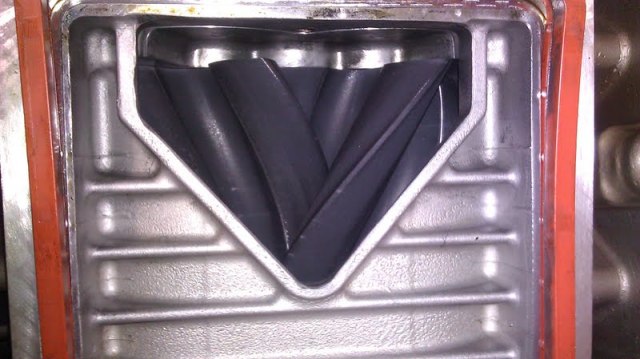

The Jag version will be up when we do this chiller install, but for a top mount positive displacement blower the single valve up to 10# boost, over get the Monster dual valve.
Just call direct and they will put it together. Ask for both Long "L" and Long "Z" brackets.
The build up on the rotors causes them to become out of balance and wear bearings prematurely also.
Here are some pics of a blower after 16k miles with the RX can:
and an intercooler w/out one for 15k miles:

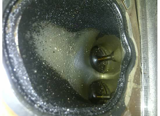

And with the DI engines having no fuel passing the intake valves, the coking issue is horrible. Here are pictures of DI intake valves in as little as 8k miles they have lost app 20% of the volumetric efficiency:
vs the same 3.6L GM v6 with port injection w/140k miles on it:
Huge issue w/ALL direct injection engines...and Lexus v8 has a partial port injection version and it isn't helpping all the much.

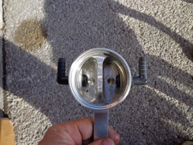

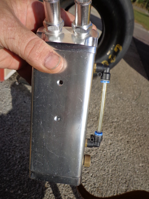

    This one is very common and is generally bought from ebay, but several company also brand it. Comes with fittings, a universal braket, sight tube to see when it needs to emptied:
    Click here to view the original image of 640x480px and 184KB.
    And the inside......notice not only is it completely an empty can, but the fittings are just punched in with metal filings hanging:
    Click here to view the original image of 640x480px and 113KB.

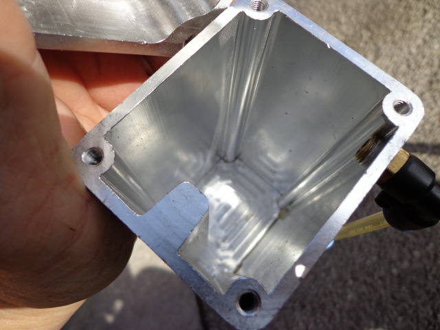

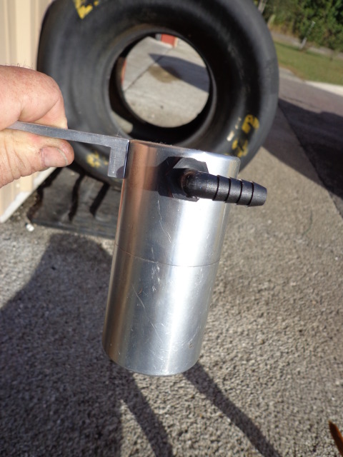

    This is another Ebay/China cheapo. Looks nice, ends are milled from billet and the main body extruded aluminum. This can is very common and is seen in many colors and with over 20 companies branding it as "their own design". Search on ebay to see for yourself:
    And as you can see, allthough it is a good size, and looks nice, just an empty can again. The majority of all vapors enter and do a quick U turn and exit:
    Click here to view the original image of 640x480px and 86KB.
    Click here to view the original image of 640x480px and 98KB.
    So again, no different than an empty "jumbo" beer can.

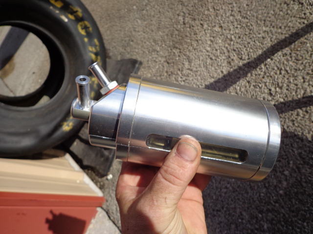

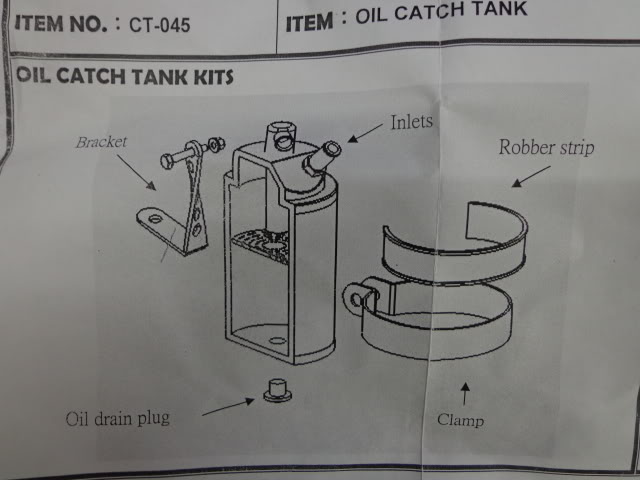

    And now to another variation of ebay/china. Sight windows and can be had in several colors or a carbon fiber wrap:
    Click here to view the original image of 640x480px and 97KB.

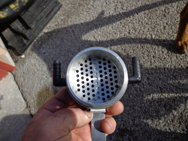

    Now the inside:
    Bonded together with plastic resin...this insulates it greatly reducing the ability to condense oil vapors....and since it relies on the plastic to seal it this one had a good sized vacuum leak where it didnt get coated, and time will tell if this resin delaminates over time from the fuel/oil vapors. It also has what the instructions describe as a "Robber Strip".....not sure what that is:
    Click here to view the original image of 640x480px and 205KB.
    Click here to view the original image of 640x480px and 37KB.
    Notice, if they would have designed it so the inlet tube protruded through the screen, it would actually have a bit better effectiveness, but since it terminates in the top the majority of the vapors just do a quick U turn back out.

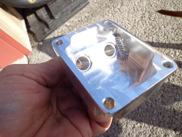

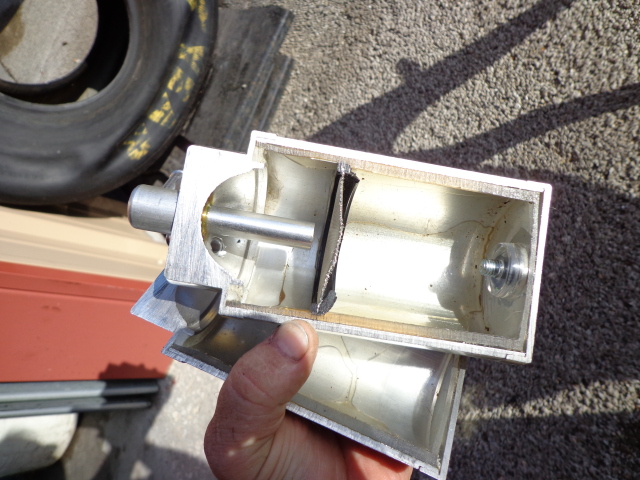

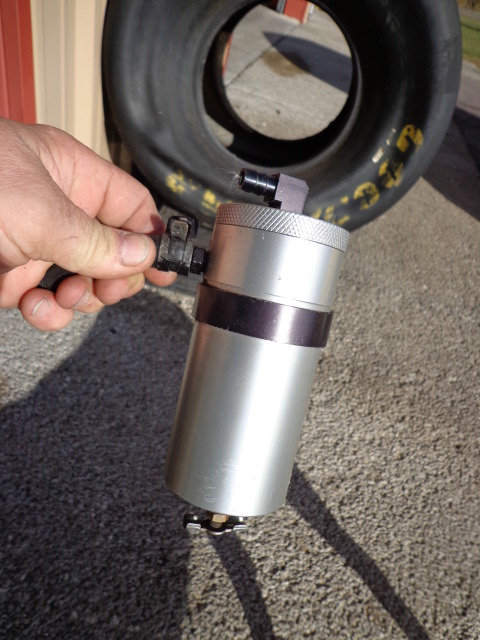

    Now on to one made in the USA, quality of the machining is top notch, excellent appearance, solid bracket. You will see dozens of variations of this with the appearance slightly different on the top and some cary very well known brands:
    Now look closely at the internal design. There is no specified inlet or outlet, and when you unscrew it you see the vapors enter through one fitting, travel through coalscing media (so far so good) but it just U turns into the outlet side into more coalscing material which acts the same way as taking a wet wash cloth and holding it to your mouth and sucking on it...the liquid pull right through. So even though it looks awesome, and the machining is top notch, since it is so small the flow never slows enough to allow most droplets to fall out of suspension so they suck right into the other side and out the outlet.
    Click here to view the original image of 640x480px and 111KB.
    Click here to view the original image of 640x480px and 202KB.
    Click here to view the original image of 640x480px and 120KB.
    A can has to be large enough so the velocity, or the flow speed through the can slows enough for the condensed droplets to fall out of suspension and not carried through (take a straw and drip a small amount of water in a saucer, suck on the straw and it will draw the liquid up completely...similar to the dentist suction tube, now take a piece of garden hose and try the same....you wont get any, or almost no liquid due to the internal volumn of the hose/straw/container used as an oil separator.

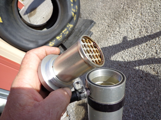

    Now on to the ones that work. Starting with the one below (has several others that brand this unit). As you can see, the oil enters the top, passes through a small chamber with coalescing material that does a good job of separating the oil and as the flow pulls through, the larger droplets fall into the bottom for collection and only the smallesr ones get pulled through. Mainly because the outlet is only 1" from the droplets dripping out of the chamber as the speed of the flow will pull a small amount through. This is a very good functioning can and allows only 20% or so of pull through and is one we endorse as worth using on most NA applications, but any kind of FI or big cube build and it will allow even more pull through. Nice looking, durable, and functional for the reasons listed:
    Click here to view the original image of 640x480px and 116KB.

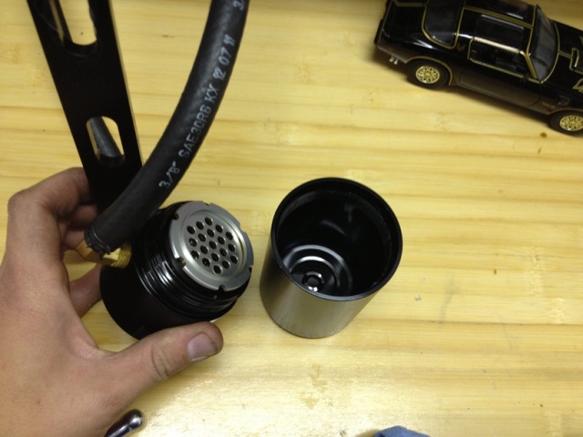

    On to the next 2 that are excellent in function and quality. The Elite and the AMW. Both are slightly different in appearance, but both use the same basic very effective design internally. Even though from the outside they may look similar to the one with so many brands that does not work well, these work excellent:
    First the Elite:
    Click here to view the original image of 640x480px and 91KB.
    Click here to view the original image of 640x480px and 84KB.
    Look above closeley. The coalescing chamber is quite large and is very effective in trapping the oil from suspension and all but the smallest drops fall to the bottom where they are trapped to drain later. The outlet barb is app 2" from the bottom of the coalscing chamber so less chane for pull through. Great for NA and mild top mount SC applications. Excellent can we also endorse.

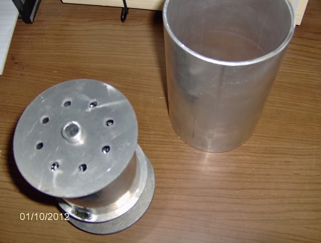

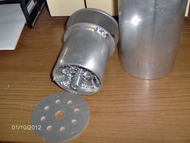

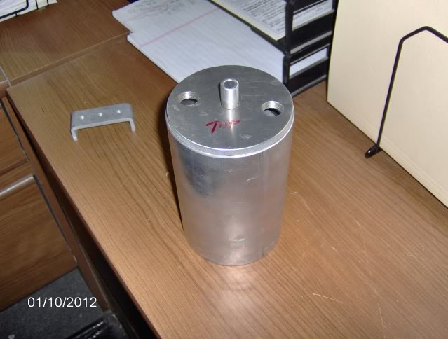

    Now the RX can. Several things in this design are unlike any other on the market. The distance the oil laden fumes travel from entering, through 3 different chambers which each have a function, is over 9" so pull through from droplets falling to the bottom for collection is near impossible. It also is nearly 1 qt of internal volume (standard can, Monster is nearly 2 quarts) so the velocity, or speed of the flow can slow enough for even the smallest of droplets to fall out of suspension:
    Click here to view the original image of 639x484px and 43KB.
    Follow the pictures below of a disected RX can. The vapors first enter the top center and travel down the dispersion tube that distributes the vapors evenly into the large coalescing chamber where 90% plus of the oil is separated from the vapors and can drop into the collection and condensing chamber. This uses the temprature differential to condense any oil still suspended into large enough drops that then collect on the outer cooling surface and drop to the bottom for collection. Then the vapors have to travel past a disc baffel into the separate outlet chamber where they have one final cooling step to allow any trace oil to condense befor exiting through a flow controlling checkvalve that prevents any back flow at WOT when intake vacuum is at its lowest level and also prevents the vapors from flowing through to fast.
    The oil laden vapors at no time mix with crankcase vapors already cleaned as they exit. Every other design has points where the dirty, and cleaned vapors mingle so there is no way to separate 100% of the oil as some of the entering vapors are always mixing with the exiting vapors.
    Click here to view the original image of 639x484px and 37KB.
