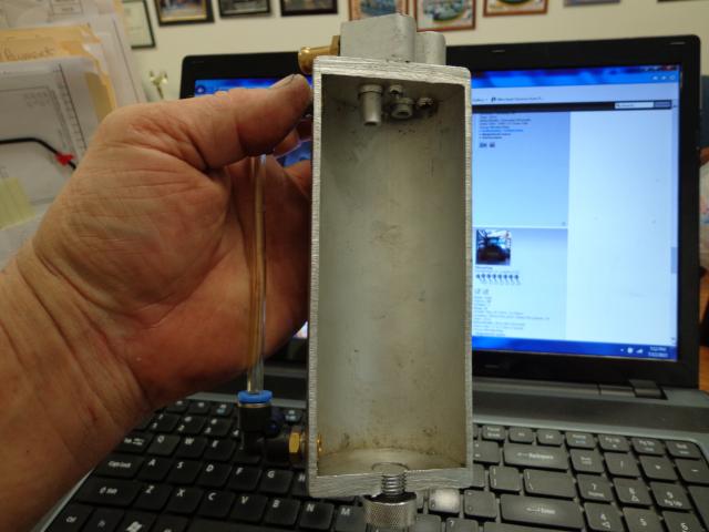

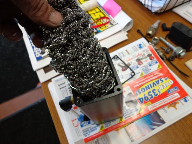

The problem with most of the billet ones is they for one, are to small so the speed of the flow through, or the velocity, cannot slow enough to prevent the condensed oil droplets from pulling through (think dentist suction tube, or sucking up spilled liquid with a straw). And they have filter media right against the outlet & inlet (as there is no designated inlet/outlet) so like a wet washcloth held to your mouth, if you suck water is drawn out...same principal.
And most others are nothing more than empty cans:
And here is a nice looking can that is the correct size (large enough internally to allow the flow to slow to a level the droplets can fall out of suspension), but no separate chambers or baffling to direct vapors through:
But they do put a scouring pad inside it:
But ANY can is better than no can, they just let a good deal of oil to pull past into the intake air charge.

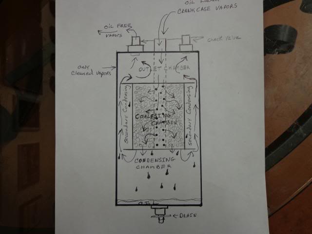

This is the best functioning on the market, excuse my hand drawn diagram:
You can see how the vapors are drawn through the center, are dispersed into a large coalescing chamber, then into a condensing and collection chamber before being evenly forced around the lower disc baffle so they make as much contact with the outer wall for further cooling/condensing in a secondary condensing chamber, then again past an upper disc baffle into a totally separate outlet chamber. This is the only one that keeps the oil laden vapors totally separate from the cleaned vapors at the outlet. Every other can allows incoming and outgoing to swirl and mix preventing 100% separation. It is also just under 1 qt capacity so it allows the flow through it to slow enough to allow all the droplets to fall out of suspension.
Most cans I think are purchased by the appearance more than function as there is so little accurate information out there for people to research and understand the issues and what makes a good solution for them.
