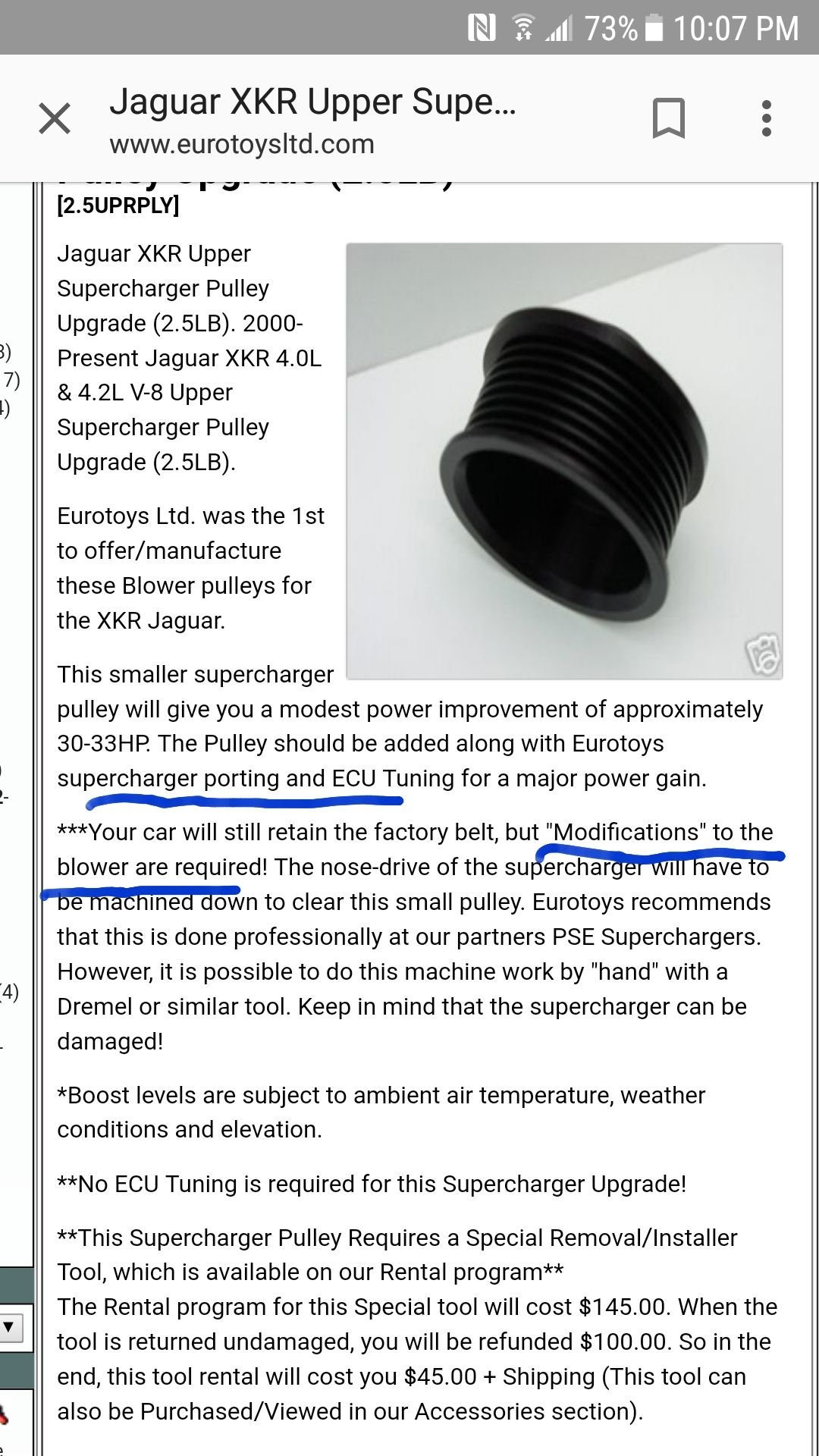

To get the full power upgrade for the pulley you need an ECU remap and that means mailing your ECU out (and given the ECU and car have to be matched having a spare ECU in the meantime doesn't really work-I have a spare ECU someplace). So you basically have a non-driving car until it comes back. Without the remap it just shifts your power curve to the left. You'd get more out of a lower rear end but I have yet to see anyone get that to work on our generation car thanks to the electronics. I'm assuming you have the upper pulley which requires you grind the Supercharger Snout. I did the pulley without the remap and just didn't think the change was worth the cost when I was done.

Thanks for the feedback. I thought these year cars couldn't be tuned? That' what I've read before. The pulley I have isn' the bigger one. It' ssupposedly the direct fit type without belt modification. The 1.5

Best to go to eurotoysltd.com and checkout the goodies for the 4.0 Supercharged Engine...They have been doing Pulleys, both top & bottom for years and have everything you will need.....I've never heard of having to file down the snout and things like that! Eurotoys can help you....call them! They have a kit just for this....
And yes if you change-out both Pulleys, I guarantee you will be a happy Guy! and NO you don't need to reprogram your Computer on a 4.0.....as a matter of fact....You Can't!

You have to file or grind it down if you choose the 2. 5 lb pulley. The 1.5 is said to fit without modifications. I'd love to have them both, honestly. The problem is getting someone to do the work.
