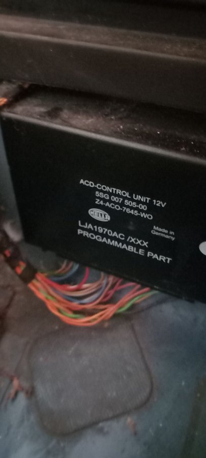

Not a programmable module. Never heard of any of them failing exept when there has been water in the boot. The module is right behind the spare wheel, check connector and cables. Do the same at all four shock absorbers.

I'm assuming this is the module for the suspension?  Exactly wherebyou said, in boot behind wheel.

Without the actual DTCs from the suspension module we are all GUESSING.
