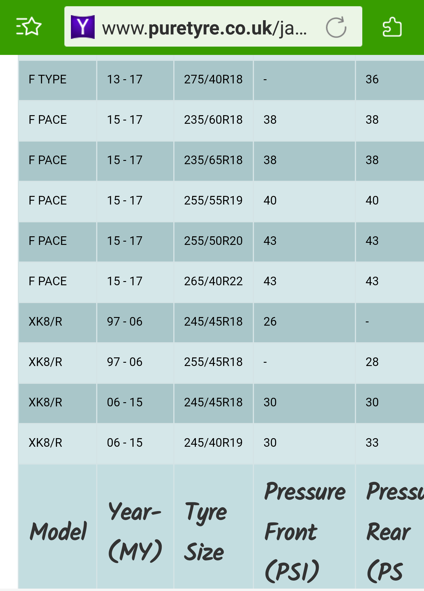

Vibration and pulling? Sounds more like you've been accosted by a pothole or a curb, and that an alignment plus wheel balancing may be in order. Knowing that my barn-find XK8 would be requiring a lot of suspension parts replaced as I restored it, and, that I would not be replacing them all at once, I bought 5 years worth of unlimited alignments from my local Pep Boys. With their coupon, it was very inexpensive and has proven a wise investment.
Do check tire pressure, tho. Low pressure alone can cause the pulling to one side... For 18" rims, it should be 26 psi front, 28 psi rear.
