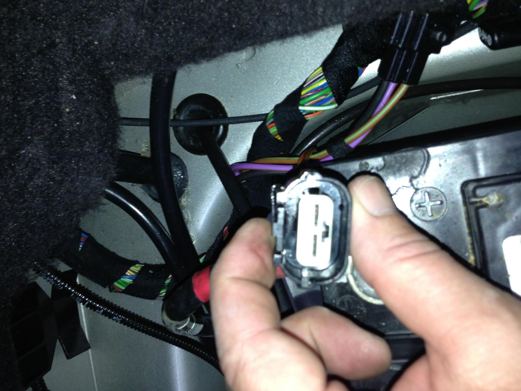

Sorry never heard of a "Transit Blu device" so I do not know if this is suitable but it is switched.
If you look in the bottom right hand corner of your trunk you may find a small white? faced plug. Apparently it was used in manufacturing when they moved the cars. If you test the plug you will find that some of the connections are switched live. Will see if I can find a photo for you.
Here you go, its not my photo. Its the plug on the right circled.
