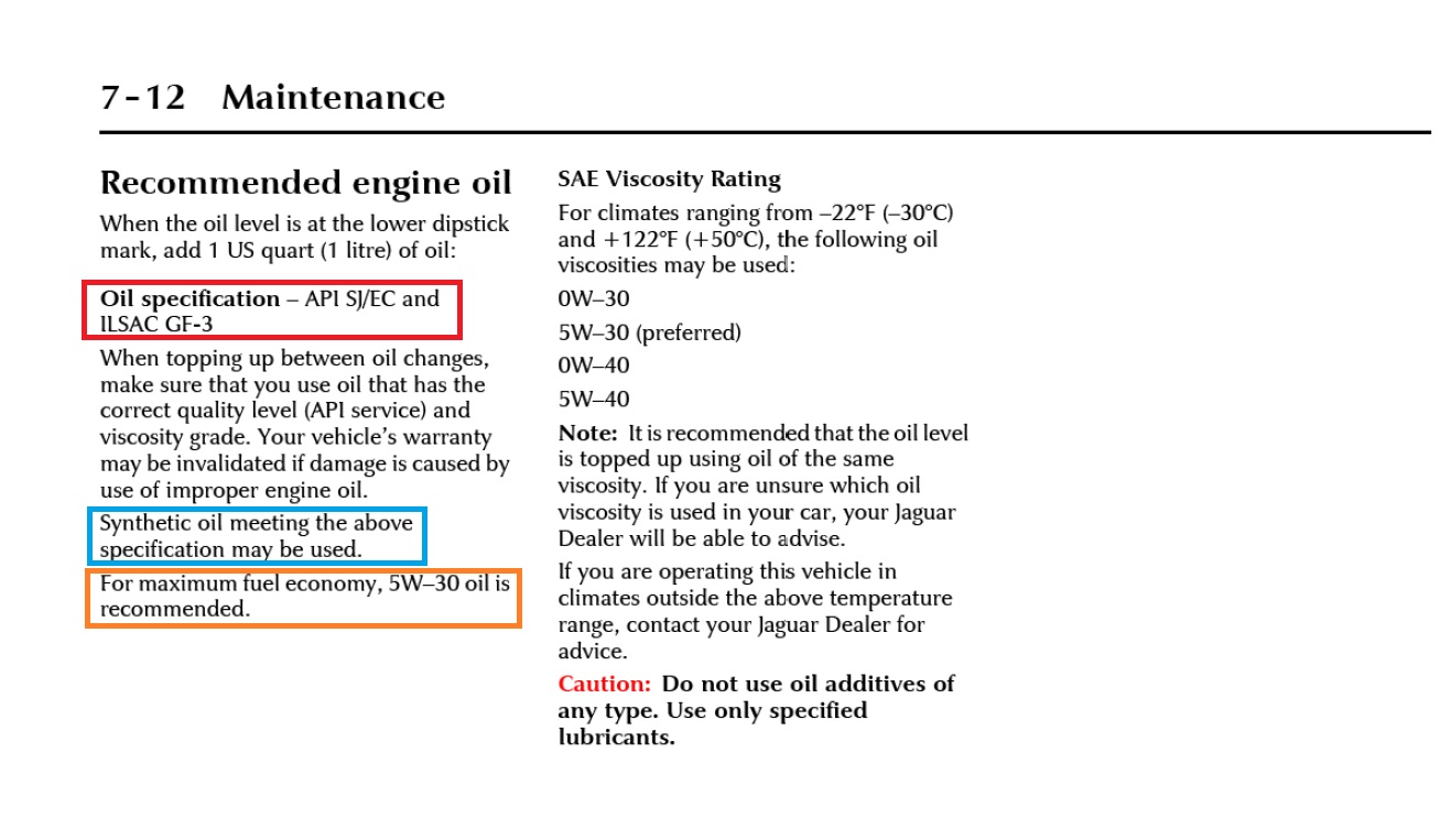

The identical recommendation appears in both US and UK Driver's Handbooks for your Model Year. Jaguar used to recommend brands in earlier handbooks but now only quotes specifications.
I've highlighted the relevant information.
The recommendation is for REGULAR oil to API SJ/EC and ILSAC GF-3 (boxed in red) or SYNTHETIC meeting this specification may be used (boxed in blue).
Additionally 5W -30 is the preferred weight (boxed in orange).
A Jaguar Dealer will use REGULAR oil for the 10K Mile / 12 Month scheduled service.
Here's the Jaguar recommendation for engine oil:
