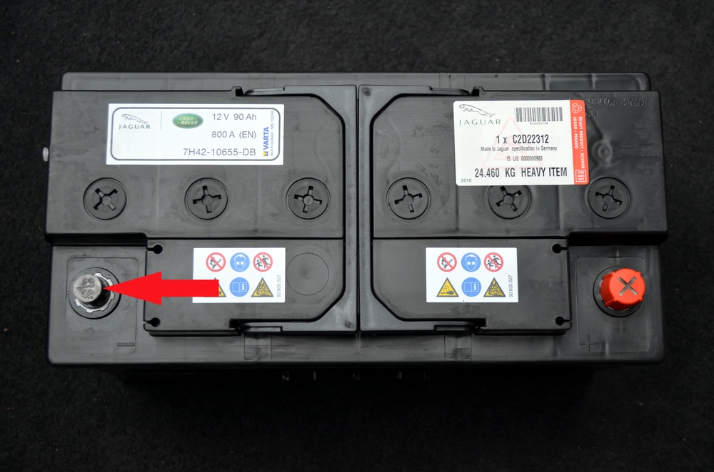

OE Jaguar batteries have the date of manufacture stamped into the top of the negative post:
This example shows 23-12 indicating manufactured in the 23rd week of 2012.
