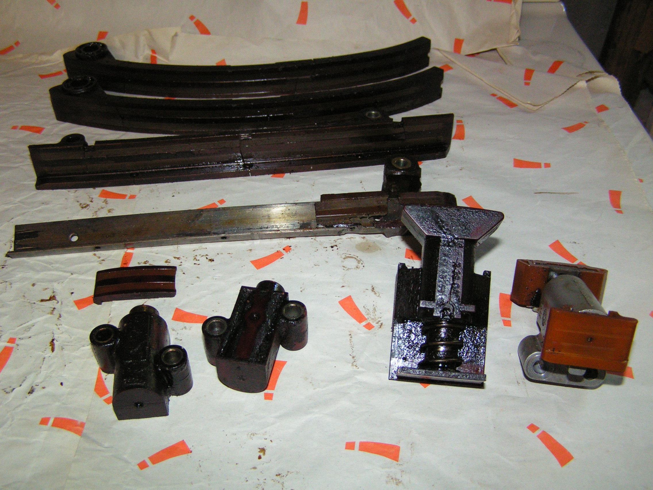

Boy, am I glad I took your advice. Go go the other "tensioner" thread for the pic of the ***** that came out of an engine that was running well, with no unusual noises. Seems the prior owner(s) did the absolute minimum in repairing items that arose, and not even basic minimum maintenance.
