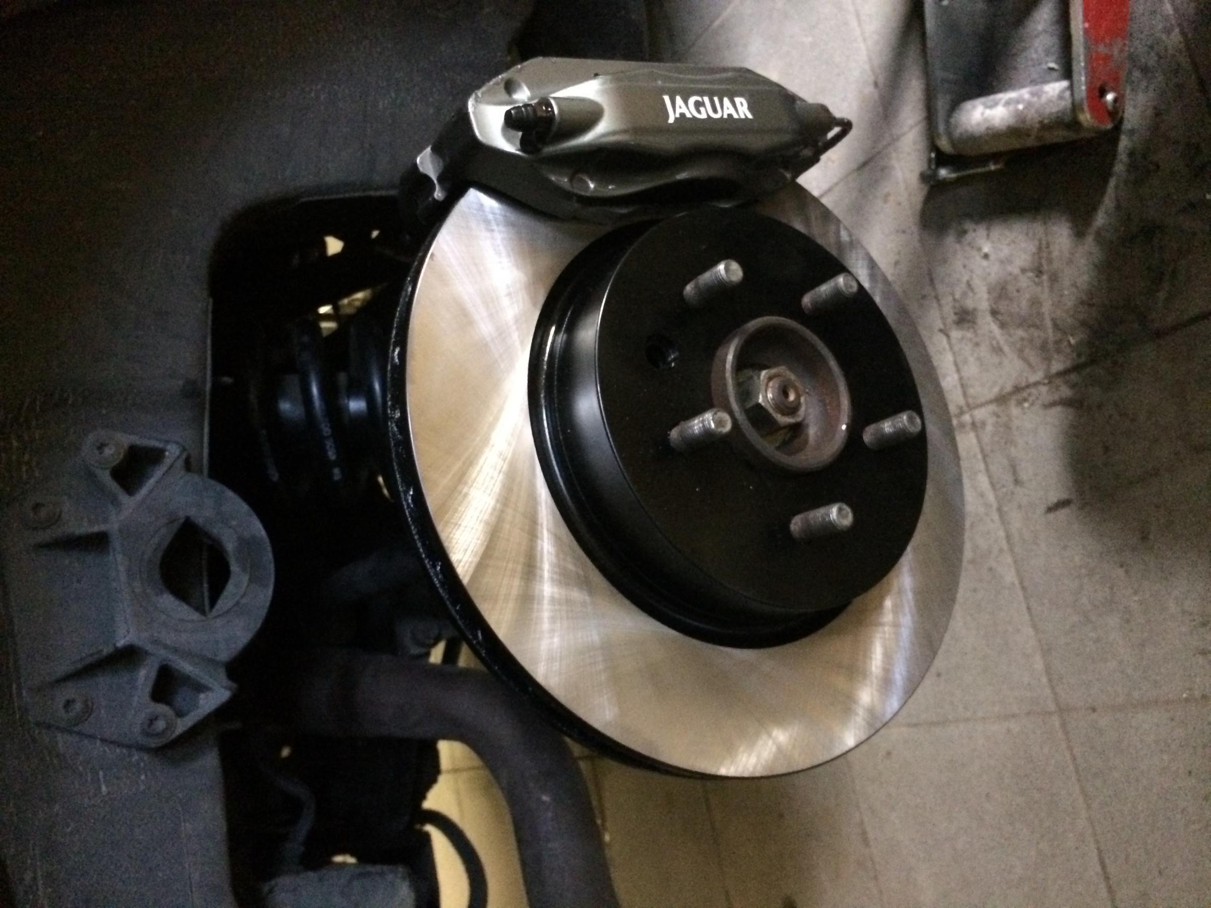

Am still more than pleased with the pads, they have phenomenal bite from cold and that only gets better when hot.
These are hungry little beasts though; they chew up the rotors just as quick as themselves.
My front pads had about 4mm left and rotors 29.2 mm (from 32)
The rears had about 3mm left and the rotors 26.4 (from 28)
Am not sure about the mileage, it could be about 25K.
Have also changed the rotors now at the same time to the 125 series from centric (higher carbon, fronts 125.20020 and rears 125.20021)
Please note that these are race pads, so they can squeal. After I used the special anti-squeal parts from Porsche it has seldom squealed, but I can’t guarantee it will work for others as well. Attached is a picture of these parts.
You need 4 x 996 352 086 00 and 4 x 996 352 86 02. This is only for the rear calipers, as I have never had any squeal issues with the front, and you need the different part numbers as the pistons have a different size.
So for the ones that are interested in outstanding break performance with the Brembo setup, these babies are the ones, no need to go larger in disc size (which are only available for the fronts, and will affect the balance)
Forgot to add, the front are type E1287 and the rears E1408. Pagid has also changed their lineup, these RS15 ones are now close to the RST3 (which I have now).
Attached Thumbnails Tested new brake pads-img_3208.jpg   Tested new brake pads-img_3206.jpg
Last edited by avos; Feb 17, 2014 at 03:28 PM. Reason: Added partnos form Centric and Pagid pad info
