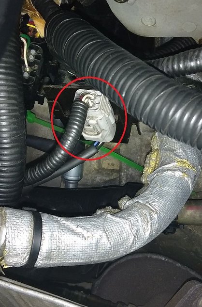

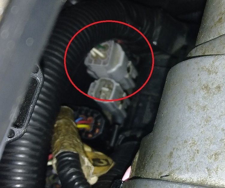

Hi Matt,
Here are the two HO2S connectors on my '98. I imagine that they won't have moved much from 97. RHS and LHS are looking forward from the rear. Check that the wiring leads to the sensor on the same side of the car as its connector.
RHS:
LHS:
Old Mar 30, 2020 | 04:27 AM

Many thanks for that.
I shall have another look when the battery turns up. I’m hoping it will arrive tomorrow.
I’ve been studying up on these sensors and the fuel trims, plus trying to find leaks. Hopefully I will get to the bottom of this.
