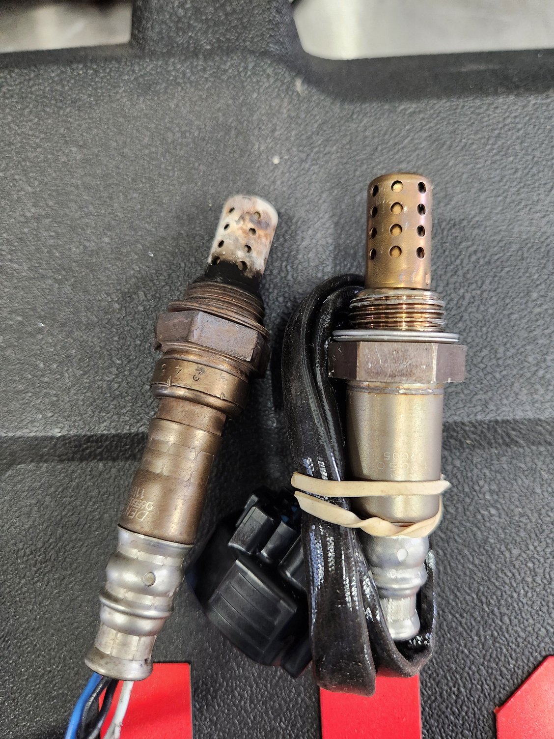

Before and after
Outstanding Y2K. How did you determine it was the downstream O2 sensor? Did you take them all out and inspect them or was there some code or message you go on the OBD2? How many miles do you have on your car? Could a car with 63,000 miles have a bad sensor?
