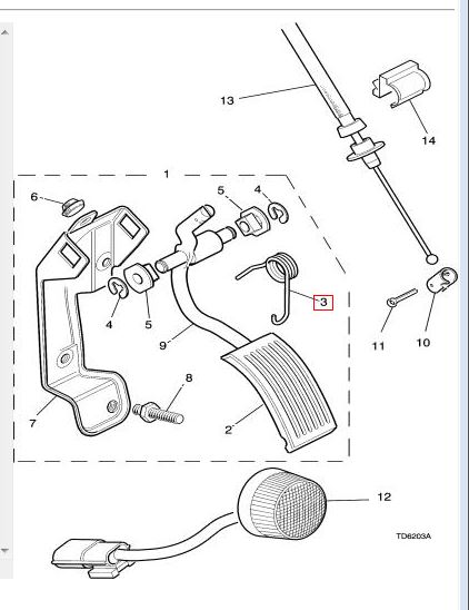

Where do I look for the throttle return spring on my '03 XK8? The amount of foot pressure required on the accelerator pedal to control ones cruising speed or ones rate of acceleration seems excessive. I think it detracts from the drivers smoothness and overall driving pleasure. Fixing that problem before drive by wire became the norm was easy. Long short. Where is the the return spring on the electronic throttle controller located?

Number 3 on the below is part number MJA4715BB priced at around $35.00 with your discount.. Hopefully this is what you're searching for?
That's it (#3 in the parts drawing). So the question is, how do I decrease the amount of spring tension the spring exerts on the pedal assembly without pulling the entire assembly apart and cutting a coil off the spring? There isn't a ton of room down there for big hands to easily pop the two C-Clamps to get the spring off. Looks like I'm stuck using a heavy foot .

Try to shorten the arm on the spring (where the 3 Points at) and "recurve" it around the pedal leaver (no 9). This way the spring will seem weaker.
