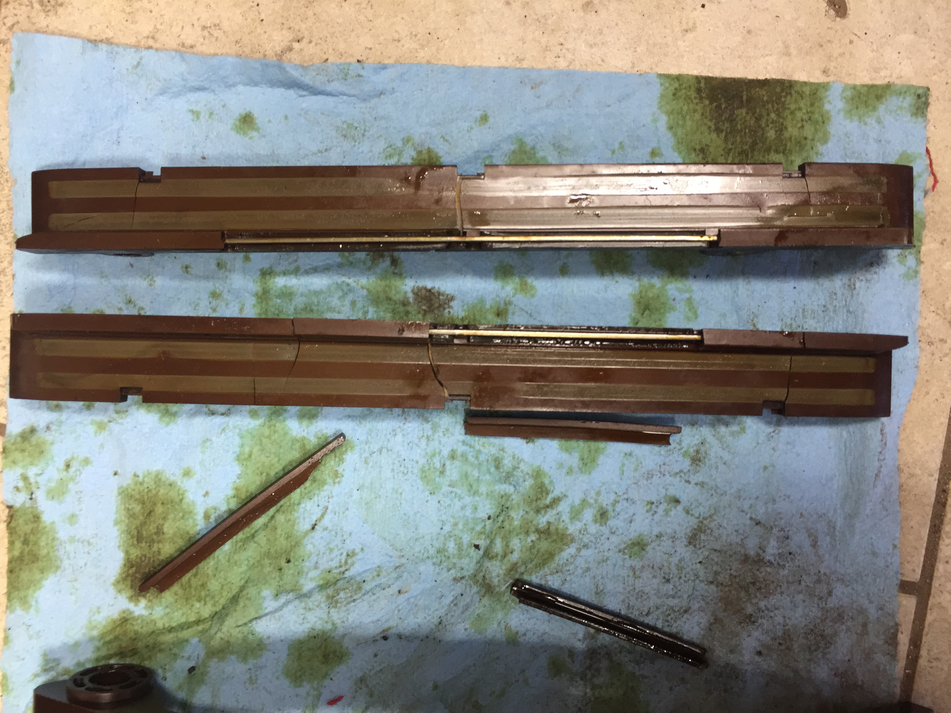

I removed the oil pan without taking the x brace out. There is enough room. When the oil pan was out, that's when I found the large pieces of primary guide in the sump pump. I know at that point I needed to do the primary tensioners and guides.
The job is not hard, just time consuming. Hardest part for me was getting the harmonic balancer off. Make sure the flywheel is locked and use as long a torque wrench with a helper pipe as you have.
Here are some photos.

the primaries were not so bad, guides were broken up, one secondary tensioner was completely gone . chain was riding just on the post. we think it actually jumped a tooth.I'm glad I did the whole job , not just the secondaries.
Old Sep 1, 2015 | 04:14 AM
johns55's Avatar
Joined: May 2014
Posts: 610
Likes: 125
Lucky you caught it before any major problems.
