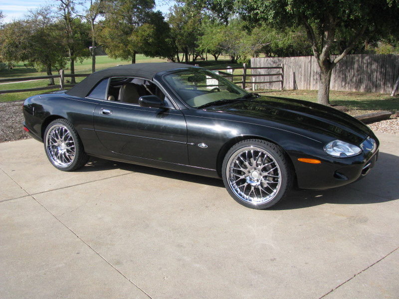

Here are some pics: with the stock and ADR wheels to see the comparison; and with both new ADR's.
Attached Thumbnails Which tires for 20"?-jagnewoldwheels.jpg   Which tires for 20"?-jagnewwheels.jpg

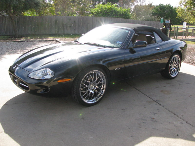

Here are more pics with my digital camera. Just my luck, a bird got me on the rear ps qtr panel just before I took the pics.
Attached Thumbnails Which tires for 20"?-jag-ds-f-r.jpg   Which tires for 20"?-jag-ds-r-f-1.jpg   Which tires for 20"?-jag-ds.jpg   Which tires for 20"?-jag-ps.jpg   Which tires for 20"?-jag-ps-r-f.jpg

Wow, it looks great. The wheels looks almost like the BBS CH's. You just need to buy the jaguar rear arch kit for 20" to complete the look.
