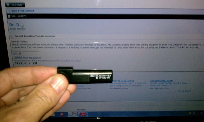

That's interesting. I went out into the garage to see if I could find it and I found this thing (in the pic below). It's plugged into a big fat harness that runs parallel to battery and it has two red wires with white stripes plugged into it. I've looked through the electrical guide to see if I can figure out what it is, but I still have no idea. However, when I unplug it everything dies. Everything electrical quits working.
OK, you got my curiosity going Rev. Turns out that is nothing more than the diode in series with the two trunk light bulbs (see the interior lighting page of the circuit diagram). The bigger mystery is why a diode is needed there?
That's weird. After I pulled it, I had to reset my windows and set the time zone on the nav system.

I believe you (it is a Jag after all) but I had it out for 15 minutes and my windows did not lose their set.
Oh... I know what happened. Earlier in the day I was fiddling with my door handle gaskets and I disconnected the battery to avoid cutting off my hands accidentally. Last night I pulled that little diode thing out and the trunk lights went out. I assumed it had killed everything electrical, so after I plugged it back in and went to see if my windows had lost their memory, which they had. I assumed that it was because of the little thing I unplugged, but in retrospect I realize that memory loss was caused by the work I did earlier in the day.
