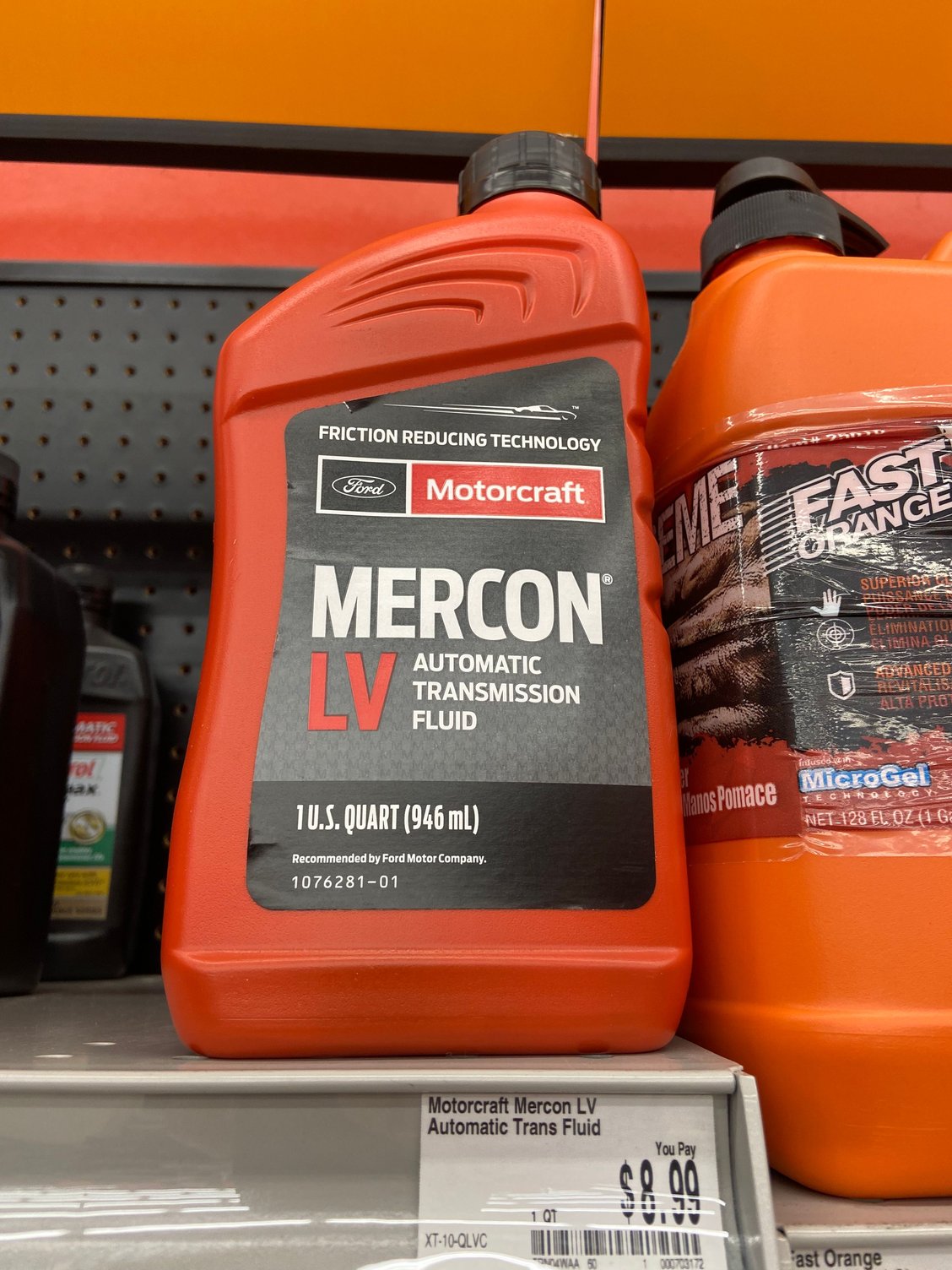

I haven’t been able to find Mercon SP.
this is all I can find

Amazon has it:
Amazon Amazon
12 quarts will likely cover a second drain/fill after a few hundred miles to further dilute what remains of the old fluid in the torque convertor.

Your local Ford dealership parts department will also have it....

I found Mercon SP at Advance Auto Parts. They had it on the shelves behind the counter. Guy said "for a Ford ?", and I said, oh yeah.
