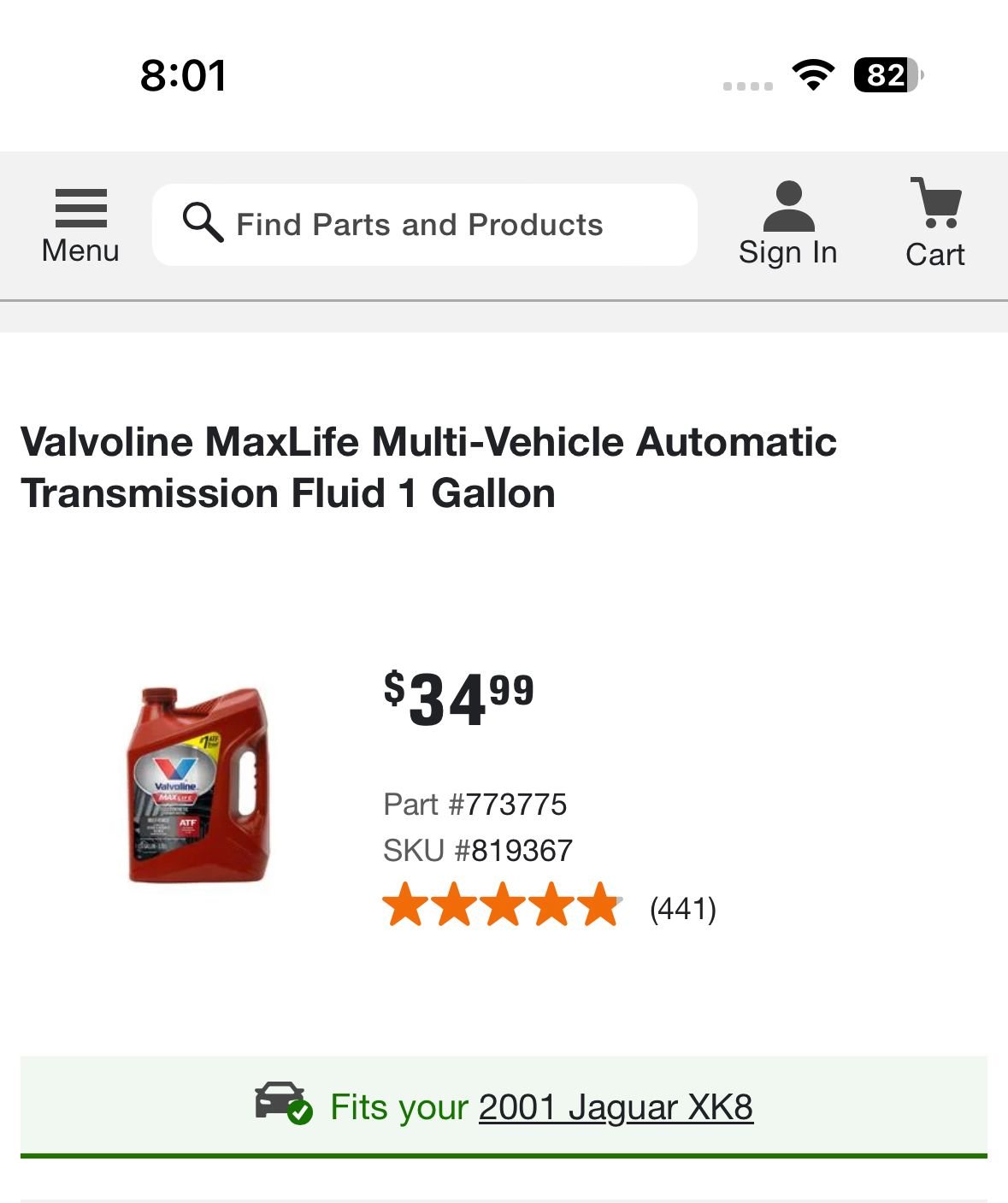

Is this oil ok to use in my 2001 xK8?

It's fine for your power-steering fluid. For your transmission, you want:
ESSO 71141 or Lifeguard 5 is the original fluid.
VW used G 052 162 A2
BMW used a 71141 under their own part number
FEBI makes a 71141 equivelent

71141 just look on ebay for the best price .Dont trust the fits xk8 ..its not a brake pad . 5 litres is not enough for a drain and refill 6-7 litres. If someone on this forum is not sure and has a question thats fine with me and does not warrant a "here we go again"
