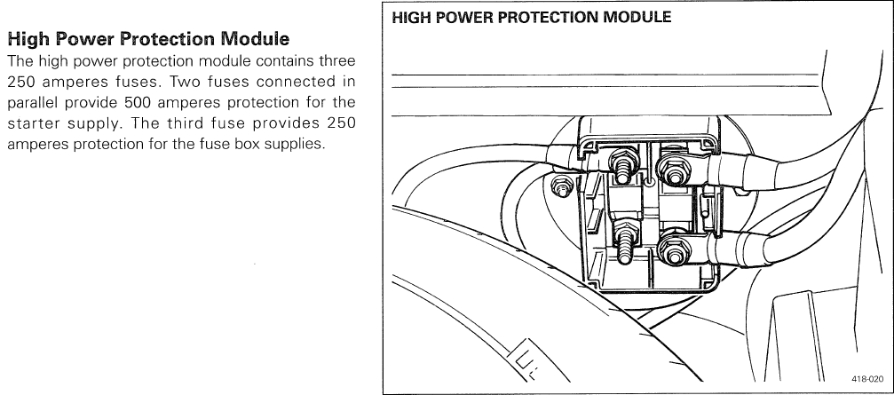

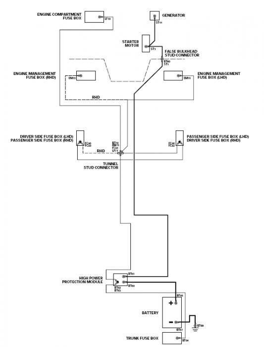

Old Nov 16, 2010 | 08:49 PM
  #60
Gus's Avatar
Gus
Joined: Jul 2008
Posts: 11,356
Likes: 2,236
From: Berlin Md.
The fact that you received a Traction Control Fault, Engine Fault and a Battery Charge fault leads me to believe that you have an electrical problem. If you look at the AJ27 oneline the power from the battery goes to the High Voltage Protection Module and I am assuming that that is what you said was warm and that concerns me. Two reasons for it getting warm, over / under charging or a bad connection. One feed goes from the battery to the HPPM then to the starter / charger the others go to the power distribution and one of them go under the hood to the engine management. If this were my problem I would pull the lead from the battery, pull the fuses in the trunk and replace them (AutoZone) and make sure all connections were clean and tight. I will tell you like I tell my servicemen you will not know if they are clean until you take it apart and look at it. The engine management feeds the TB, Throttle Motor, EGR Valve, VVT, Pedal Position Sensors along with many other things. Check and clean your connections and replace the fuses.
