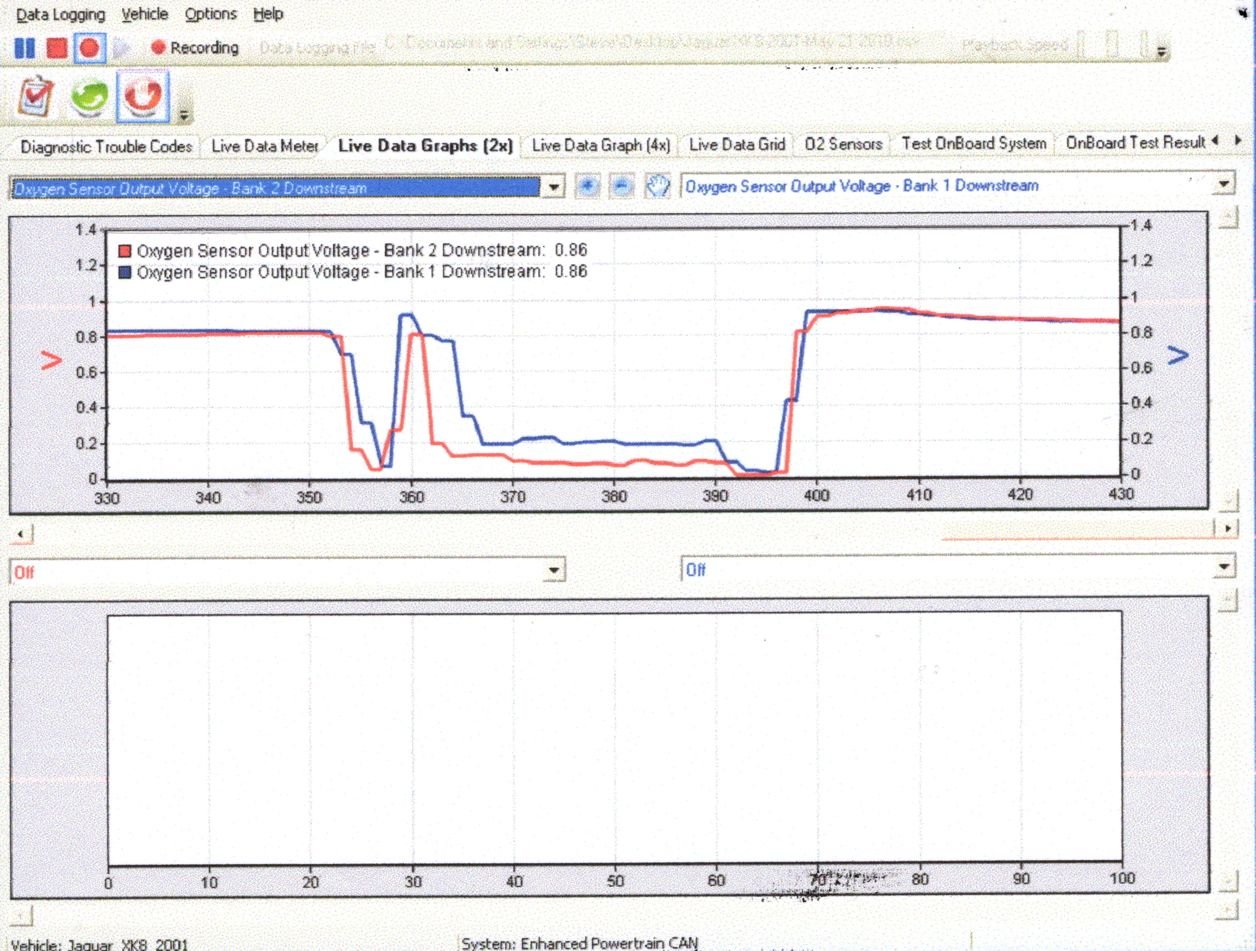

So I checked the the downstream O2 sensors.
Normally they both should have similar traces like in the first pic. I blipped the throttle twice. In steady state throttle position I believe there should be a straight line.
So without touching the throttle I also saw this.
I think that sensor may be going bad? comments?

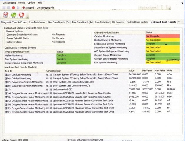

Here is monitor information
Anyone know what the oxygen sensor monitoring does ? Could it detect what is happening?
