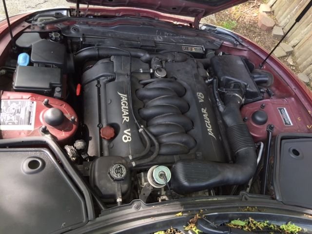

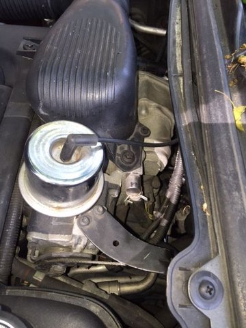

Also, I'll add some pics. I took a look at the throttle body connections. I know it wasn't the shop cuz it was there before I gave it to them. It looked suspicious. The wiring seems to be glued to a connection. Maybe the connector clip broke and somebody glued it on??
Thanks again guys,
Justin
1997 XK8 150Kmiles V8 4.0L
engine bay
left side of throttle
right side of throttle with questionable glued connection

I can't believe you still have the throttle with the shiny metal vacuum actuator version on your car. Only the first few thousand cars had that throttle.
You can install a 'known-good' AJ26 throttle assy from 1997/1998 XK or 98 XJ (or 98/99 XJ supercharged) as they are all AJ26 engine management.
Jaguar had many issues with the throttles over the years. There are TSBs for both the AJ26 AND AJ27 throttles.

Mine has the chromed vacuum adapter also. I thought it was probably a replacement and now you tell me it's a dinosaur.
I have had to clean the connectors a couple of times and I think the guard tracks have caused some cruise control interruptions, but it's still working well otherwise.

So I figured out the revving issue. The wiring that was done with the "suspicious glue" was put in all wrong. I had a friend who's a performance jaguar mechanic take a look. He said whoever installed it put the wires all wrong so the ecu was going crazy. He fixed the wiring and now she purrs again����.
