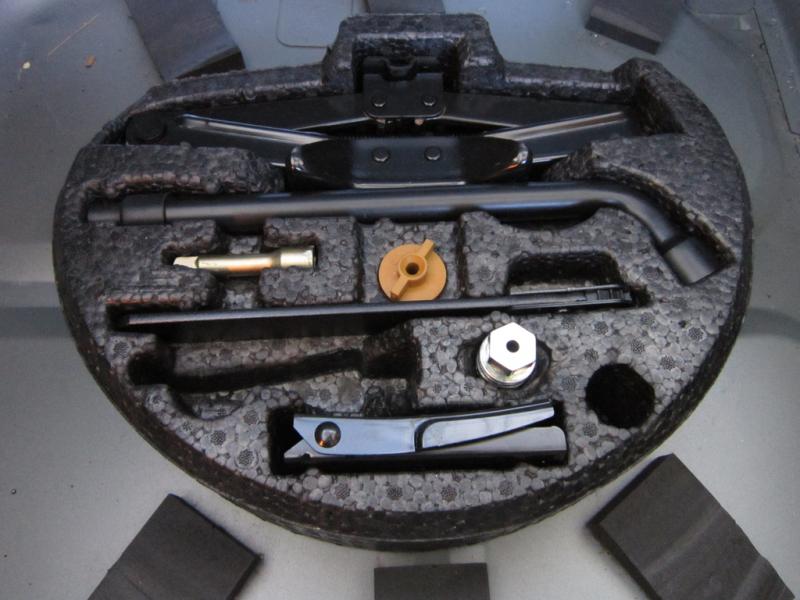

I just had my rear pads replaced and was retrieving the wheel lock tool from the trunk below the spare donut. I noticed a couple of empty slots in the styrofoam tool holder and was wondering if those were just extra slots for other applications or am I missing a couple of tools. In the attached jpg you can see one of the slots below the bar (to the left of the wheel lock socket) and another empty round slot to the right of the socket. Not sure what these could have been--any ideas?
Thanks,
Doug

The only thing I see missing is your tow hook, When they shipped them over they had them installed for shipping one in front another in the back. The dealers remove them and are suppose to put one in the tool kit. But many never made it into the kit. It's a lot easier to toss it in a box than to remove the spare and install it. Bob Gauff, (Motorcarman) did have a few he was selling a couple of years ago, he may still have some left.

To tow the car itself, you will have a position at the back on the trunk floor, righthand side...... yours will be covered by a flap built into the bumper, 2 positions at the front one either side with a black plastic bung covering it

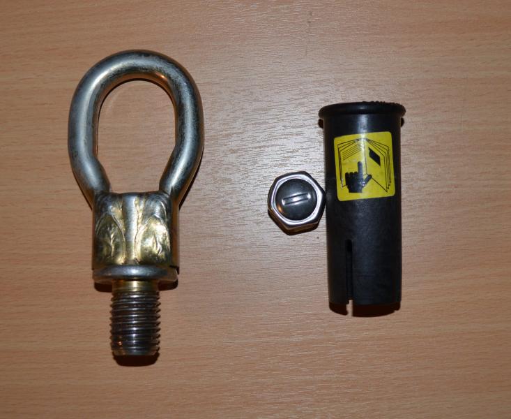

You are missing the Tow Hook and the black plastic tubular tool for removing the locking wheel nut covers.
XK8's leave the factory with Tow Hooks fitted front and rear. They are more for tie-down than for towing.
Part of the PDI instructions to dealers is to remove both, fit blanking plugs, stow one Tow Hook in the tool tray and discard the other. In practice, they are often missing from the toolkit.
How do you remove the locking wheel nut covers without the tool shown on the right of the pic?

As to the wheel lock tool, I do not have the type of lock shown in your photo. At each wheel 4 of the lugs are the standard 2-piece kind and the fifth is a McGard style lug with a pattern embossed on the front. The shiny socket shown in my photo is for removing the McGard lug.
