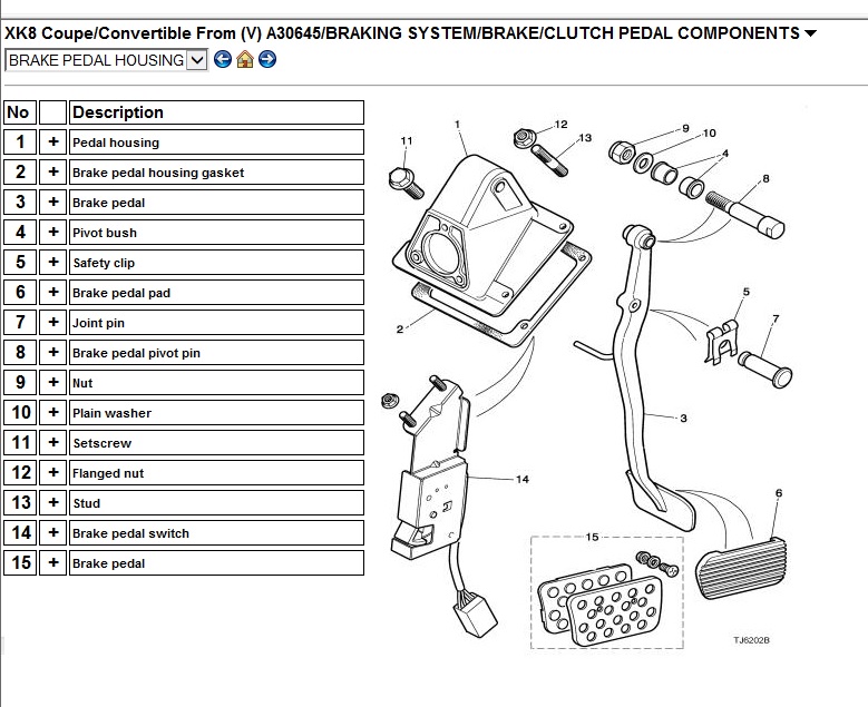

.............. any time I touch the brake pedal or release it I hear what almost sounds like a musical tone, a click of sorts sounding like it is coming from the lower left side of the driver side dash............
Could it be coming from the Brake Pedal Switch (item 14)?
(click on the image to enlarge it )

Thanks to both of you. What does the brake switch do?
Old Jul 10, 2013 | 06:01 AM
jimbov8's Avatar
Posts: 2,069
Likes: 666
From: Uk
Brings on the brake lights, deactivates cruise control and also the gear lever selector solenoid.
