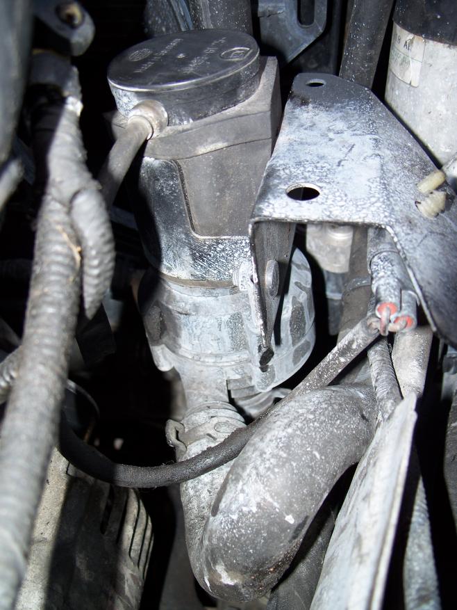

Default Pics of the pump
Hi again
Here is a pic of the Hella pump that is whining. It is mounted on a body at the front of the engine bay on the drivers side. It has a pipe that runs up to either side of the supercharger.
The whining starts as soon as the ignition is on and does not change volume or pitch with enine speed.
If you could let me know what this is and why it is whining that would be great.
Many thanks
Karl
Old Apr 8, 2009 | 12:37 PM
Brutal's Avatar
Joined: Sep 2008
Posts: 7,255
Likes: 2,209
From: Damon /Houston, Texas
Yep intercooler pump, depends on how loud its whining. You can try a water wetter that additional has seal and pump lubrication and does a good job of lower coolant temps. Redline and other make water wetters that increase surface contact, by reducing water tension in the coolant passages. Much like stopping soda bubbles from sticking to the side of a glass. But you probobly need to flush the coolant system and maybe just change the pump after you do.

Thanks Bruce.
I think I will go straight for a new pump, the whine is quite loud.
