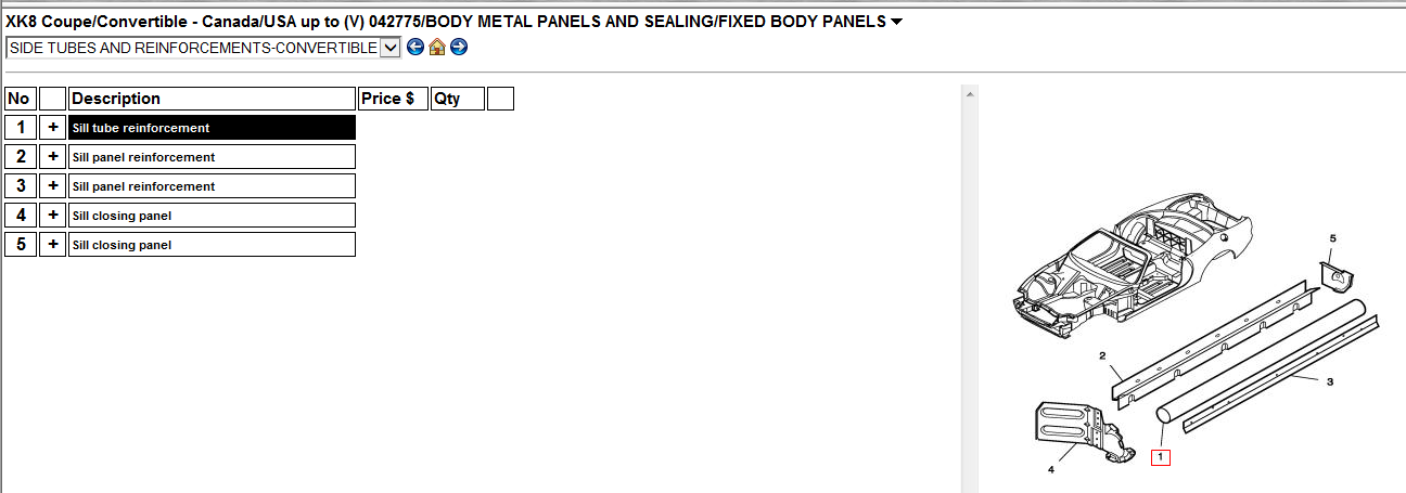

After removing the drivers side wheel well liner, I noticed a 4 inch welded tube running aft just above the rockers. I don't know what to call this other than a unitized body component added for rigidity. This tube has a rubber plug which I removed to find a bit of rusty water inside.
I stuck in a 2 foot screw driver which found no obstical. I imagine it is hollow and probably runs from the front wheel well to the rear wheel well. This may be added to Cabriolets to aid in lost stiffness due to not having a roof? I'm only speculating at this point.

Hi.
You are correct. The convertible has an extra reinforcement tube. How you got water in there, I don't know. Dry it up and put some anti-rust inside.

I didn't realise that was a steel tube going all the way to the back, I will need to have a look inside mine now.
