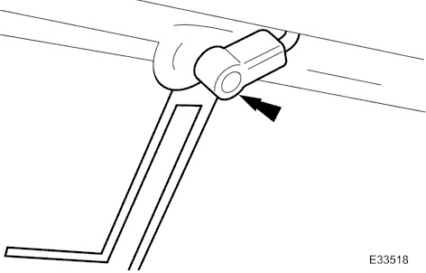

Both remotes never work or only work intermittently?
If it's never then try reprogramming. If it's intermittent, check the harness/connection to the alarm aerial at the top of the rear screen.

Your tip has helped, Graham - many thanks, but they seem to need very precise pointing?
Old Feb 26, 2015 | 01:40 PM
That is strange. Having to operate closer to the vehicle or point directly at the aerial is usually an indication of failing batteries but you've changed them.
