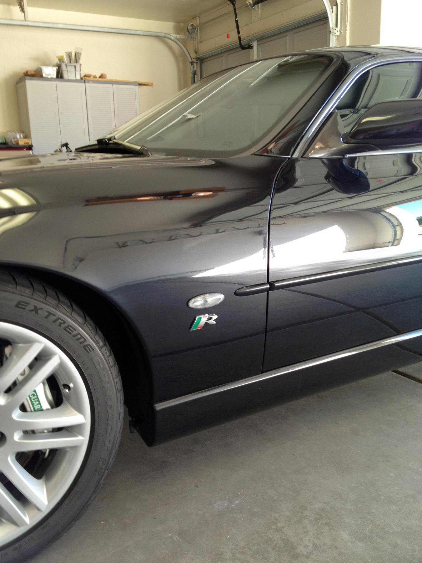

I have been traveling a lot lately and finally got some quality time with the ole cat.
She got a wash some minor maintenance and I thought I would replace the R badges that were starting to look a little worse for wear.
I expected this would be an easy, heat gun, peal it off and apply the new badges, but it was not to be so.
When I bought the car I could tell that it had been painted all over but when I removed the old badges I found that someone had left them on the car and painted AROUND THEM.
A couple hours later after wet sanding with the superfine then rubbing it out with course and then fine compound, it looks decent. Not great, but I was able to break the edge down so that it is not too noticeable.
Seriously, WHO DOES THAT!?
Anyway, I decided to try some new style R badges that I found on eBay for a reasonable price. They seem to be well made, and look pretty good, if I do say so.

2003+ x100 had the square R badge on the wings under the turn signal repeater.
The x150 had the stylized R on the boot that I used in place of the square badge.

Originally Posted by prettybluefin
the R looks awesome! i am getting ready to take my faded rectangular plate off. i tried the credit card method, but is using the heat gun much better? mine is really stuck on there. did you clean with rubbing alcohol before new one is put on? any help is appreciated. thank you!
Heat gun is HIGHLY recommended. Makes removing them much easier, and a lot less likely to do damage in the process. You can even use a hair dryer in a pinch, any amount of heat helps.

Be careful with a heatgun on plastic emblems as they will melt very easily. I would only use a heatgun on metal emblems.
Adhesive removers that contain naptha work better than alcohol.
Attachment 100244
Charlie - I think you did a great job... I definitely can't tell from the picture that you had any issues with the emblem / paint. Great job!
